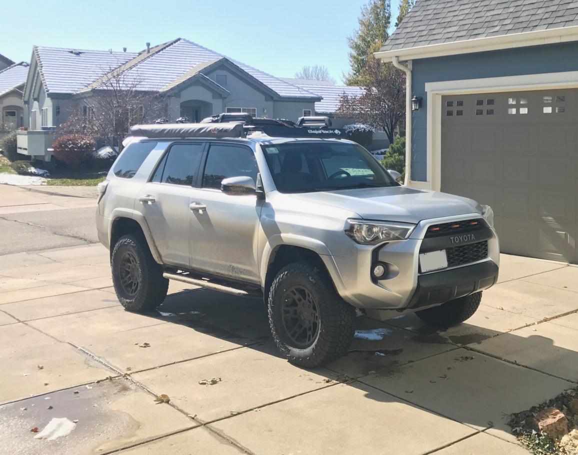

For the record,
I went off and switched LT to SL. 285/70/17.
I'm running 2.5" setting 7/5 Biltein 6112/5100 with 1.5" spacer in the rear, with FX Pro 8.5" wheels.
The fronts are about even on 1/2 tank of gas.
THE RIDE IS VERY NOTICEABLY BETTER IN SL THAN LT. So for any of you with this dilemma, I would 100% opt for the SL (p).
There is mininal Rub, only on full turn reverse against the mud flap.
I have about 22.5 inches from mid hub cap to fender bottom. Perhaps the weight of the skid plate and roof rack.
Also took the P tires off road a bit in 6" of snow in the CO mountains up some high inclines in 2WD. No slipping.
VERY GOOD TIRES. Thank you. Hope this helps.

^I have an extremely similar setup and my experience is the same. I did get rubbing up front to the point where I chopped up my fender liner to get rid of rubbing. Beyond that, these tires have been incredible. We have snow in the forecast tomorrow night. I’m dying to try these in the snow again and compare my last winter experience with the KO2 and Ridge Grapplers to what I remember these doing.
