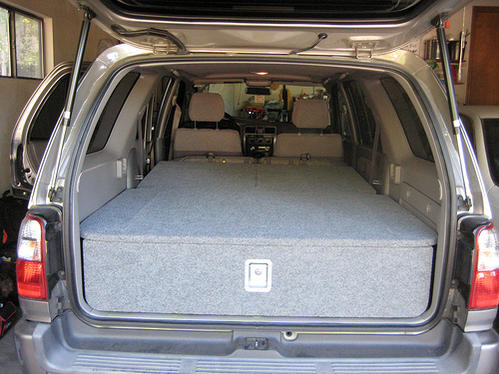

What's up everybody! Just wanted to say hello and share some photos of my cargo box/sleeping platform. I feel it's the least I could do to help contribute to this amazing site. (Just hope I did it right. Not the greatest with computers.) Got my 2002 Thundercloud Grey Sport Edition last May and went online to find out how to fix my driver side door lock and came across this incredible site with loads of info. Everyone always seems like they're willing to lend a helping hand and giving their two cents into any discussion. The only other mods I made were the Deckplate and ISR mods. Pretty happy with them!

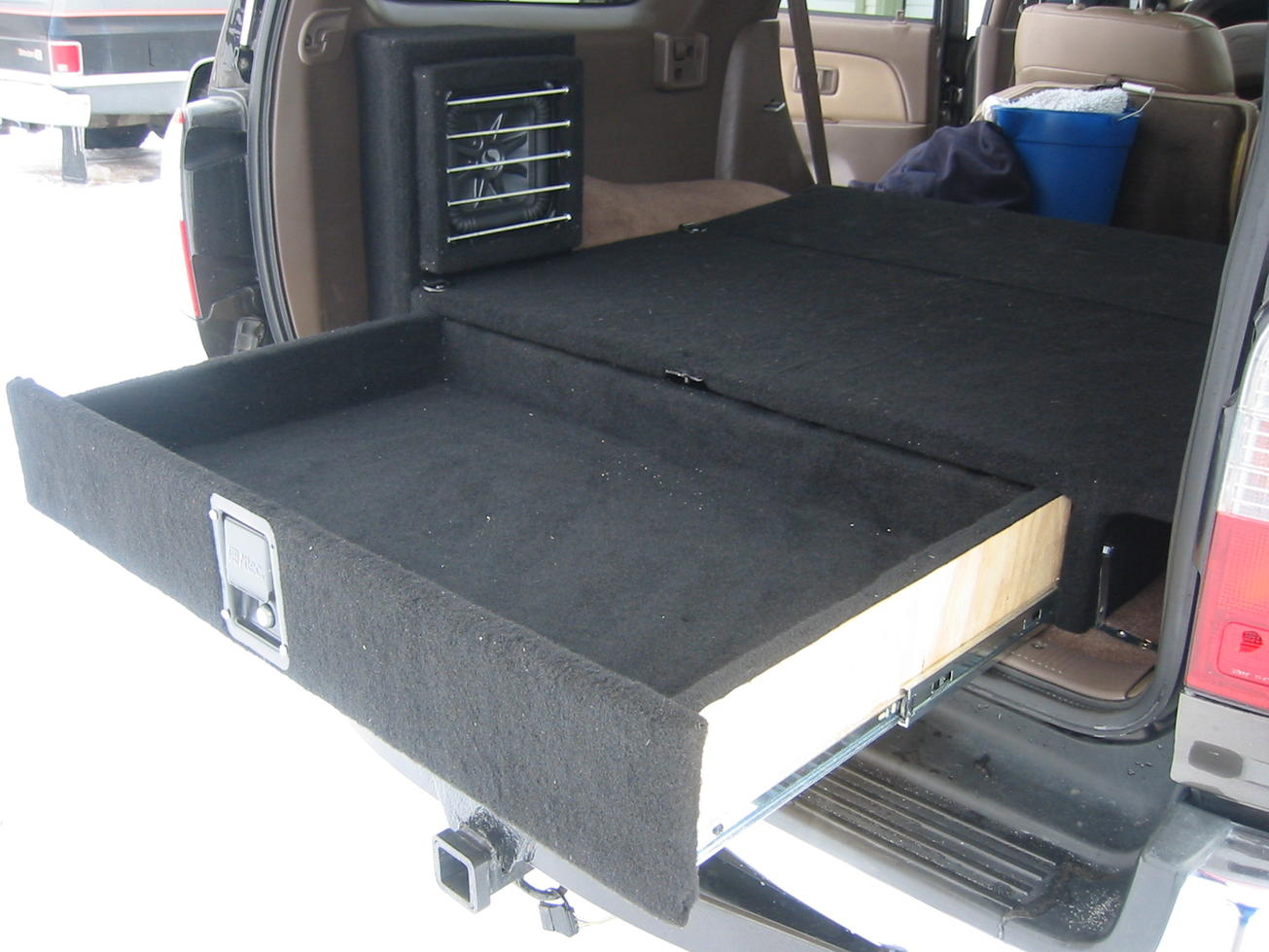

Looks great, nice job! I've been contemplating doing this myself. Looks like you can still use the rear seats with the front extension out.
This is very cool. I've been working on something similar for my '91 Yota pickup, and after seeing what you've done I'm rethinking everything. Nice work!
nice setup! I'm going to try making something similar this week, what brand are the metal drawer rails you used and where did you get them? And if you take out the forward portion of the platform do the rear seats have room to fold up like normal?

that looks pretty sick, how much did it cost you to make? Ive been looking into making one and trying to find some plans but ive come up with nothing. Ive also got 2 12" subs that id like to keep and would just have to figure out where to put 'em. Any ideas?

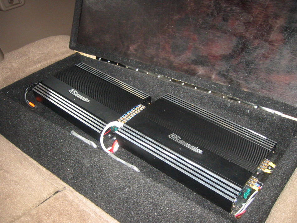

Subs work best in ground pounder configuration with the storage system like that. Only issue you will have is insufficient air flow to cool your amps.... thats why I'm ripping my system out...

Hey Thanks All! And sorry for those of you who checked the bad link first. The inspiration for building came from checking out other people's posts like skyrat, glennyoshida, JSMarine and BajaRunner. They all had their purposes for building the deck boxes the way that they wanted - and the fact that they built it themselves is what finally convinced me that I could build one myself. I think the fact that I am very detail oriented helped!
The total cost was about $210 and everything was purchased at The Home Depot with the exception of the Locking Latch. Found it in a link JSMarine posted when he built his storage drawer. The drawer slides are 22", 100 lb capacity I believe. I would post some of the plans but most of it was done by eye and the measurements for the pine frame around the drawer was written on a napkin. I can post more detailed pictures if anyone wants to see it from other angles. May take awhile though.
The back seats are fully functional. There is a gap behind the seats. that is about 12" in depth due to the fact that the storage drawer doesn't extend fully into the platform. This is where I store my sleeping bag for now - with room to spare. The only compromise that I had to make was sacrificing some open vertical storage space - for obvious reasons.

I think I'm about to build one of these. I am going to have a 12 inch down firing sub box in the top left and a compartment for my air-tank and compressor for my horn in the top right. Then behind those I want to put a 18-16inch drawer from holding random supplies. I don't care about building the bed pat as I will probably never be sleeping in mine. I just want something to look nicer and get my big sub box out of the back.
Here's mine. I got my two amps up front and a 22" drawer behind them. My 8" solobaric sits on the side. I have a front platform I put in to make a sleeping area. The girlfriend and I can fit quite well. We use it to go camping. Works waaay better than a tent. Plug the 12volt fan in and crack the rear window. Now that lilving!
