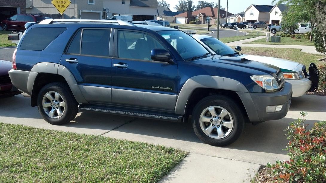

Whats up fellas I just picked up an '06 Runner and need to change somethings. This is my first DD suv, I have always had fullsize 4wd trucks but decided I was ready for a change now. The truck is exceptionally clean with low miles so I looked past the 22's thinking maybe I could deal with it. Its been 2 days since I bought it and all I can think about it changing the wheels out... but before I do all that I have to get rid of the rake. I have been reading the forum and decided for my needs the cornfed 1" should work but I am just not sure it will be enough lift. What do you guys think? Should I get the 2/1 and just leave off the rear?

go for the daystar 2/1 spacer setup it'll be the cheapest option, ride good on the road, and get you the stance your looking for. just make sure whatever spacer setup you get is a top out spacer and not a coil spring spacer.
factory is about a 1inch rake from rear to front which makes the running boards and the roof rack level. so if you put the two inch spacer up front and leave out the rear 1in spacer it should level out the rake, then if you want to pick the rear up a bit throw in the one inch rear spacer.
you'll lose some caster adjustment but it shouldnt be enough to cause the steering to be loose. If you dont like the effect it has on the steering go for a set of SPC light racing adjustable upper control arms to set the caster back to factory.
Thanks a lot that makes perfect sense and was exactly what I was looking for. I had a daystar kit on my last F150 and had good results with it.

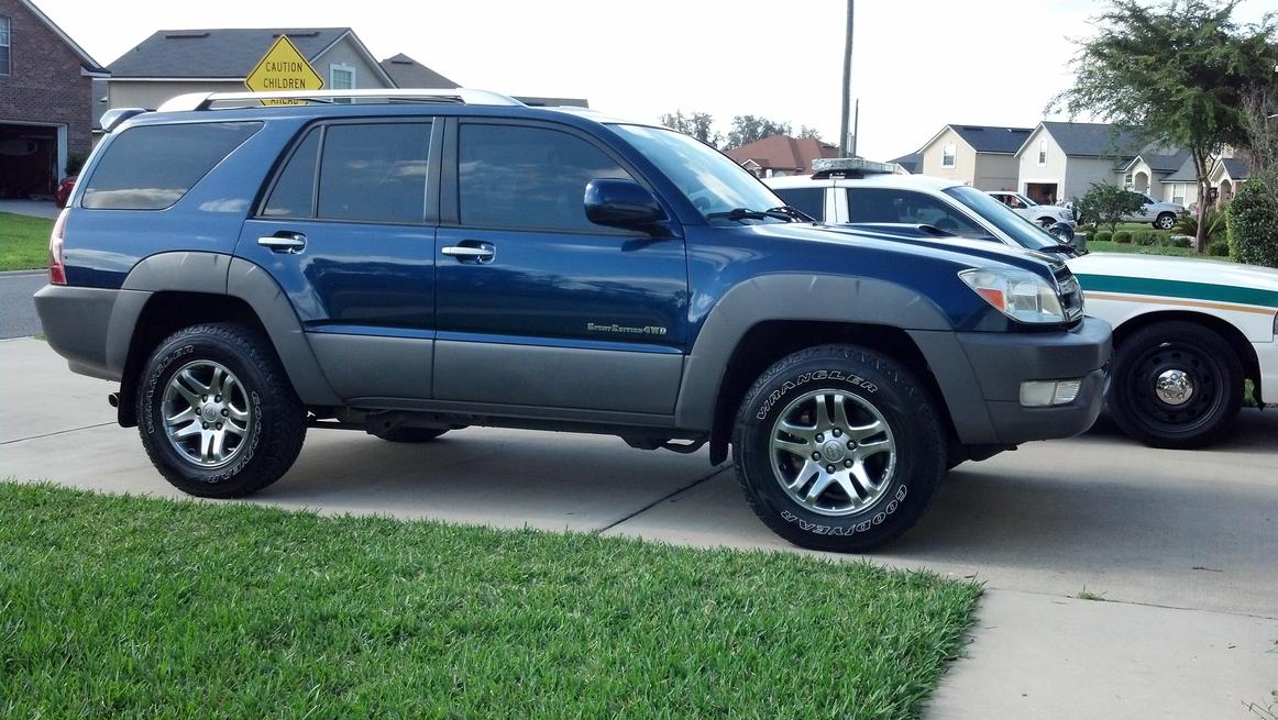

Check out the split spokes from tundras or sequoia's. I replaced my stock sport wheels with the gay sequia limited wheels and they look way better. May be because of the cladding though.

Second vote for SCS or the Konig Six shooters
As a fan of six spoke wheels, I opted for the TRD FJ cruiser wheels and I really like them. As soon as I saw them on an FJ I knew I was going to get them one day.
