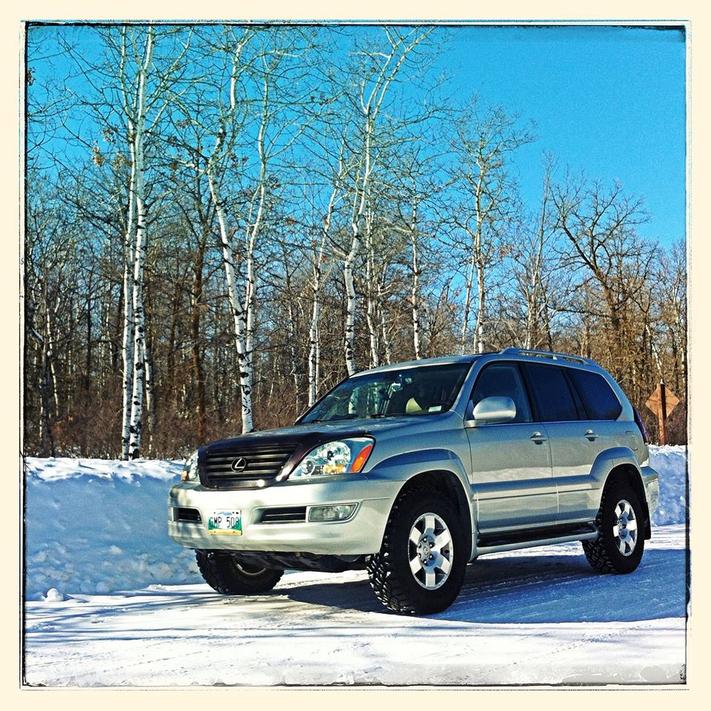

Finally got a chance to take a pic of the plastidipped grille with the truck clean.

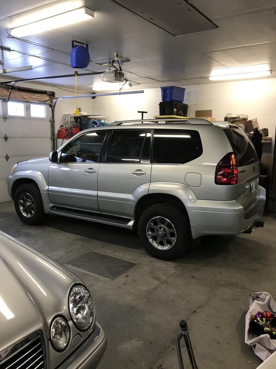

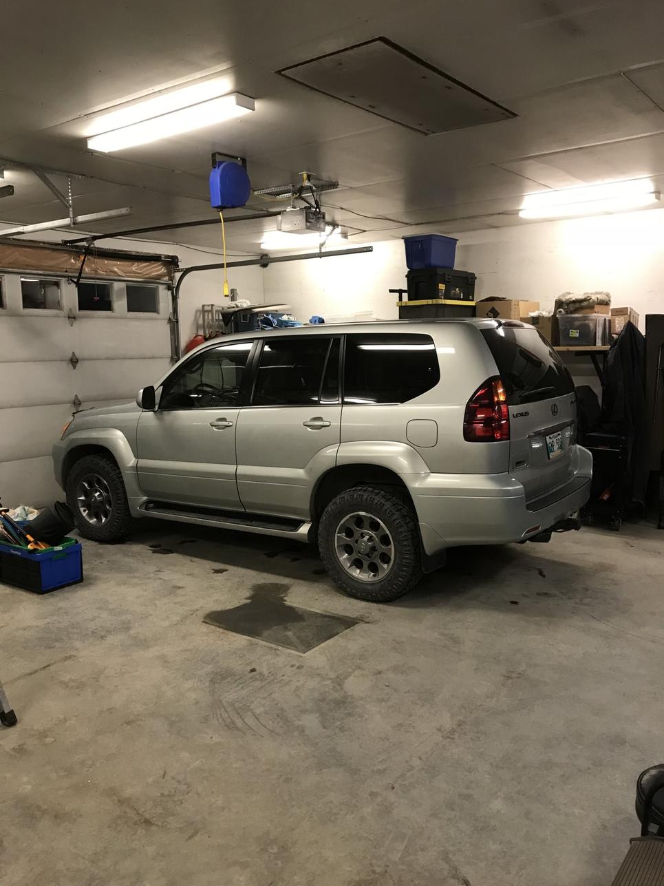

Time for a quick update, this truck has been the wife's DD for a few years now, and it's been rock solid for us, just oil changes and fuel (lots and lots of fuel).
We've put 90K kms on it in that time, and it was time for some new tires. I was VERY happy with the performance of the Duratracs on this truck, rotated regularly and they still have 11 & 12/32 tread remaining (18/32 is new)! But with winter coming I wanted some fresh tires on it, and took the opportunity to go back down to stock size rubber, as we just don't get any benefit other than appearance from the larger rubber, and several potential cons (can't be helping fuel economy, lost performance, taller gearing for towing, etc).

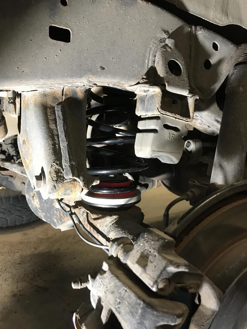

The FJC wheels were also starting to peel and could use a refinish, so I switched it up and got the newer style FJC 8-hole wheels, which really changed the look of the truck. Just before this I swapped out the rear air suspension for FJC springs and SSO conversion kit, which I've been very happy with so far. The airbags were starting to deflate when it sat in the cold, so I figured it was best to address before it actually failed, and with a spring conversion there's a definite end to the project in sight, no domino effect potential. It now sits about 1/2" taller in the rear than with the air setup on "N", so fully loaded it shouldn't be much different than stock. The rear air was nice, but was becoming a liability. The pic shows both spacers in the SSO kit, it sat too tall and I had to remove both to get the results I wanted. The spacers are good for 1/4" each, so 1/2" difference with them in vs. out.
I'd like to delete the roof rack as well, I think it would look cleaner, and MAY cut down on cross-winds pushing it around on the highway. We will never use the roof rack on this vehicle either way.

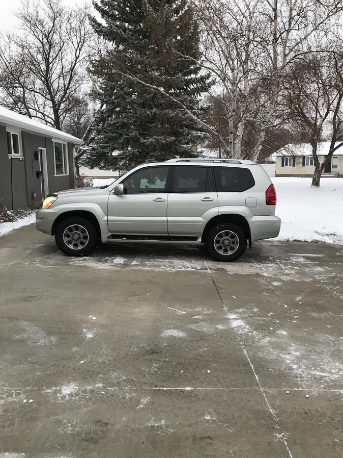

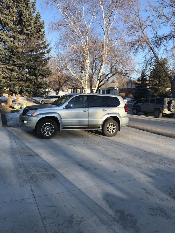

Snapped a couple pics with the roof rack removed, I prefer the look a lot!

Looks good without the roof rack. I might have to go this route. I think you commented on my thread in ClubLexus.
