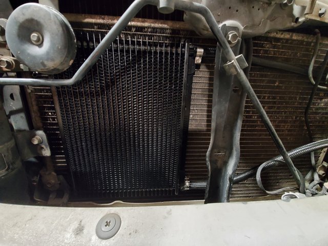

- Hayden 678 trans cooler w/ Magnefine magnetic filter

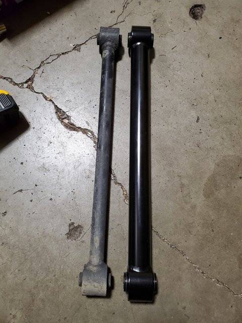

- Rokmen Trail Series lower trailing arms

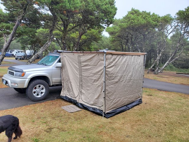

- ARB 8x8 aluminum case awning w/ tent add-on

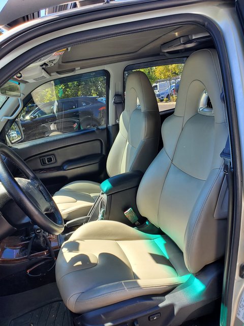

- RX8 leather front seat conversion

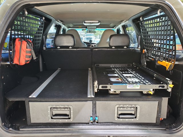

- Rear storage box/camp kitchen built by McKinsey Craft, modded by me to include black carpet dye, locking 36" sliders, & Tembo Tusk XL fridge slider w/ cutting board attachment
- Sherpa rear cargo base (removed the carpet underneath and it works perfect with the box)

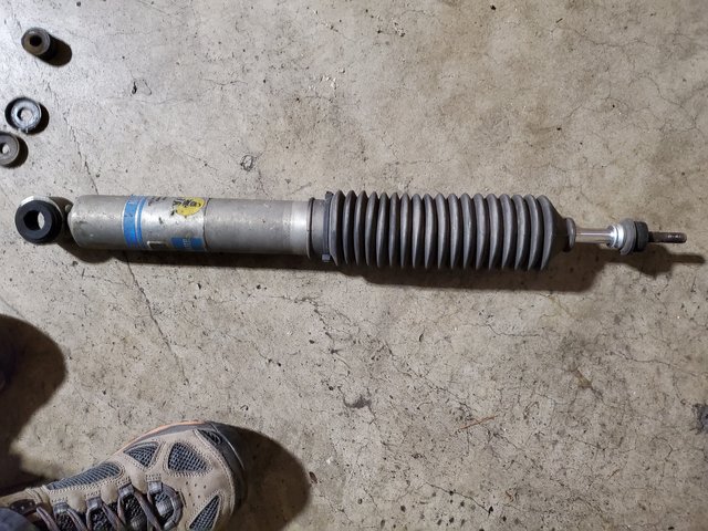

Out with the old...
In with the new...

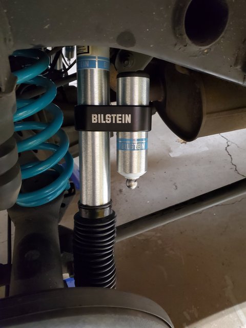

Put some 4th gen 5160's in to keep up with the 210v's. When sourcing these, I looked at the long travel 3rd gen 5100's and found out they were just stock length 4th gen shocks (33-187174). After that revelation it was easy to figure out that the 5160's were going to work just the same!
33-187174 ("long travel" 3rd gen/standard travel 4th gen 5100's):
Collapsed Length (IN): 14.91
Extended Length (IN): 23.5
25-227611 (4th gen standard travel 5160's)
Collapsed Length (IN) 14.83
Extended Length (IN) 23.5
The base mount is wider than the 5100's, but the bushing is a different design, so they ended up having roughly a similar gap between the mount post on the axle and bolt (~1/2"). The 5160's are perfect (so far) for these springs! Firm to the point where it got rid of most of the body roll that came with the 5100's after the sway bar deletes, but soaks up all of the road still. Can't wait to test them in the trails this weekend!
Those are some comfy looking seats! Really digging the black on black interior too! What did you use to make all the plastics black? Any plans to change the headliner to black as well?
Danke! I believe the previous owner said he used Hi-Tech plastic paint for the panels. For the headliner, I was thinking about doing a fabric wrap. The gray looks nice, but it also looks gunky from the dye. TBH, once I put the Raingler full net in, you won't see much of it anyway because I'll have camp blankets
and towels stuffed up there.

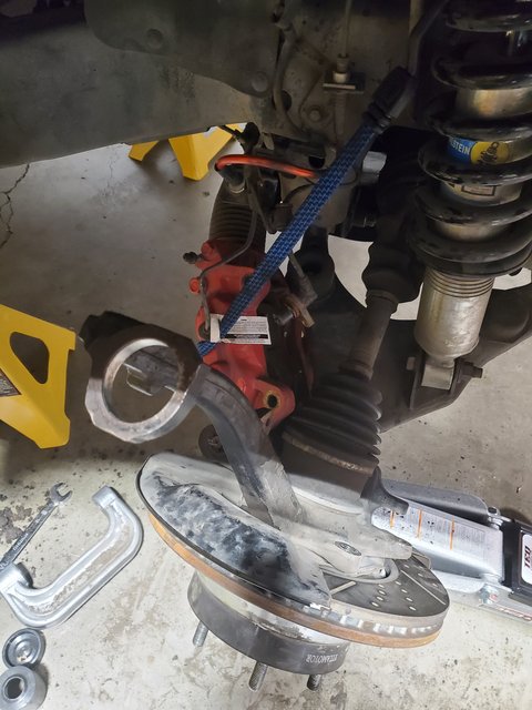

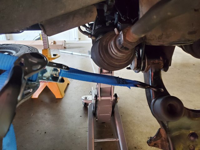

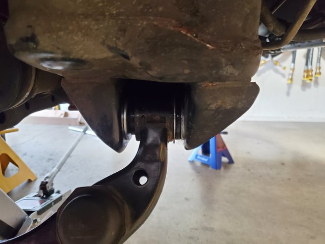

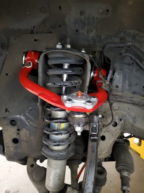

I'm putting in JBA UCA's today, so I'm hoping to get a little more out of the road feel up front to go with how great the back is now.

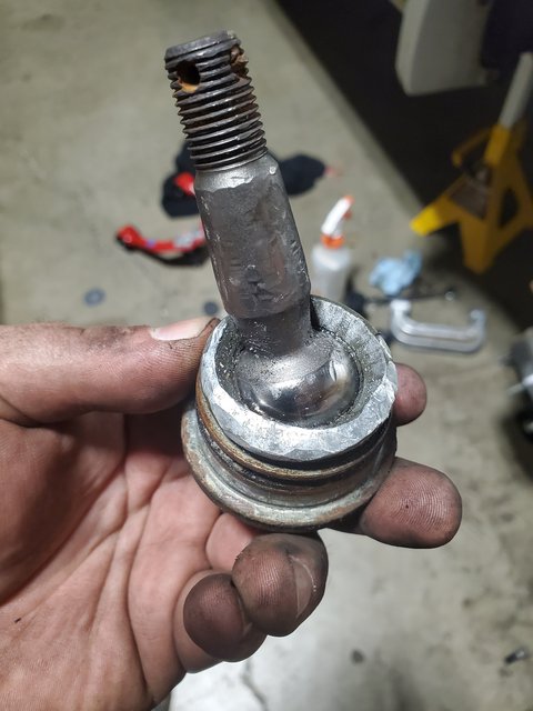

The JBA's are in and boy were those press-in UBJ adapters a project!
I opted for the "beat them the **** out" option when it came to removing the old UBJ's despite them originally appearing to be good still. It was great therapy, but this is how they looked when I was finished:
Getting these guys in was a nightmare! And yes, that is my blood, lol!
Like the bonehead I am, I forgot to pick up emery cloth on the numerous trips to Home Depot that were made during this install. It probably would've made things easier to get the lingering corrosion out before trying to put the adapters in.
I was using a Dewalt 1/2" impact and it took everything that it had, along with a fair amount of mallet smashing, to get the ball joint press to work; I'm glad I opted to buy it instead of trying to return a loaner that got the shit beat out of the bottom!
The end result made it all worth it though!
The stock UCA's looked like their bushings were original and were no longer doing their job well. The JBA's have nearly eliminated the bump-steer that I had been feeling and it's like the front end definitely has more freedom on dips and bumps. All she needs is an alignment and this new ABS issue figured out! I need to diagnose the ABS engaging during corner and low speed braking. Pretty sure I yanked on the drivers side wire a little too much because I couldn't get the sensor removed from the spindle easily and didn't feel like messing with it any more than I already did. Worst case, I buy new sensors because they look easy enough to replace.

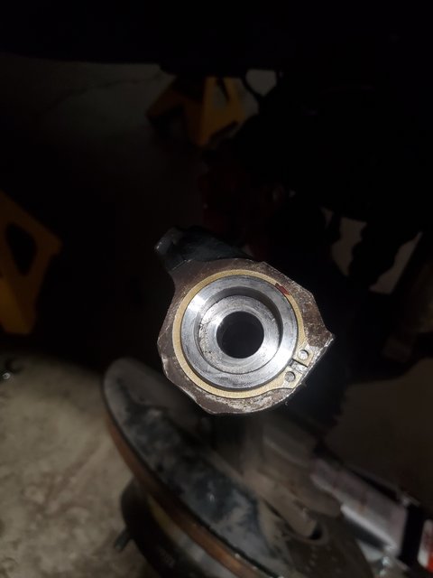

Make sure you're holding the sensor in place while you tighten the bolt down, kids! The moment I looked at the passenger side sensor (the only one I was able to remove the other day) today I could see how crooked it was, lol. Pulled it, cleaned it, lubed the o-ring, and put it back in (while holding the sensor side in place)... no more ABS slow speed braking activation!
Got the alignment today and kudos to JBA because the camber was barely off from their shop! This truck drives so good for over 260k miles now!

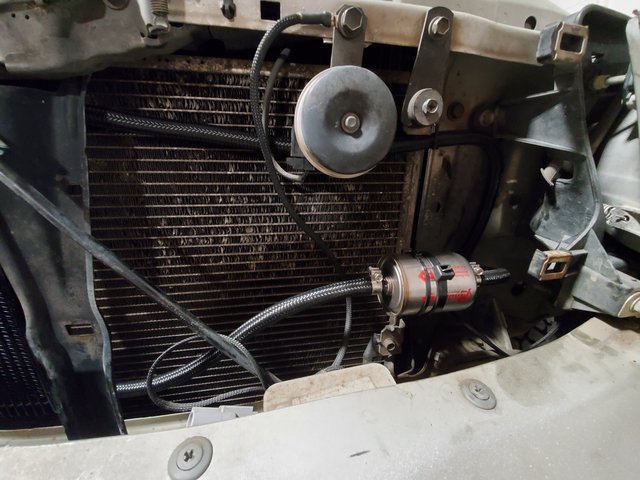

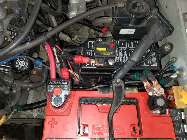

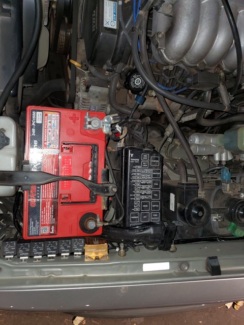

I set out to do "the big 3" the other weekend and was reminded of why local corporate stores suck in the time of COVID. Everywhere around here was out of 4AWG wire and connectors and the 2AWG stuff was really limited. Add to that shit Kicker battery terminals that look nice, but wouldn't secure to the posts and we have the garbage outcome that you see in the second pic. Just a hodgepodge of ill-fitting connections and last-minute parts.
Fast forward to this week (and $250 later) and we have the final result in the last pic. Boy, I love how this turned out! I opted to crimp instead of solder because the pellets I bought for the 4AWG ring connectors didn't fill up the wire area enough for me to feel confident. I actually ended up using the 6AWG connectors with the 4AWG wire, which yielded excellently secure results. Also got a Blue Sea 12-terminal fuse block because I want to add to more lighting and also clean up the lighting wires that already exist (that will be a whole other project as I've learned). The 1/8" ABS sheet I used for the block and breakers will need to be reinforced because it's already bowing down around the breakers.
After seeing how much wire tension was on the first iteration, I knew the final product would need to have bends on the connections to help them navigate around the Group 34 battery. What I found worked was to put the flat of the connector into a vice and use a thicker screwdriver shaft to apply pressure at the crimp. That gave good leverage to bend without causing any issues with the wire. After that, add the mesh sleeve and shrink tubes.
Now I've got room for my incoming ditch lights, scene lights, and any other electronics I can find dash space for.

The new battery/fuse box setup looks good! I was just looking under my hood trying to see what's possible, I bought the same fuse box years ago for my Subaru I need to dig out and make a bracket for, didn't know if there was enough clearance on top of the factory fuse box but looks like you had no issues there!
Following along as it looks like you're doing just about everything I either need or want to do as well! Just on the other side of the river to ya in east Vancouver/Camas area, picked up my 2000 a bit over a year ago with 127k on it but haven't had any extra time/money to tackle things and still trying to research what's what as I come from the land of lowered cars!
Thanks, neighbor! I grew up in the classic car scene with my dad and brother, switched to imports like all teenagers, but never had the cash to do much until the last decade. Instead of sticking with cars the whole time, I fell in love with the Honda Ruckus and decided to dump all of my available cash into squeezing every bit of performance out of its 49cc motor. I was keeping up with 150cc GY6 swaps (60+ mph on flats), so I accomplished everything I needed to there, which leads us to today, lol.
The fuse box fits perfect in that space with plenty of clearance up top! I wish I went for 1/4" ABS instead of 1/8" because it's already drooping a bit. I'm thinking that I'll just do some thicker acrylic in the near future for style points. My biggest issue so far with this thing is not having a garage at my place! I have to go to my work to do almost anything, especially this time of year. I'm hoping to remedy that problem by the summer, so we may end up being even closer neighbors soon! Gotta get rid of the income tax bullshit to help fund the last remaining items that are almost all big ticket items (bumpers, SC/V8 swap, etc.).
