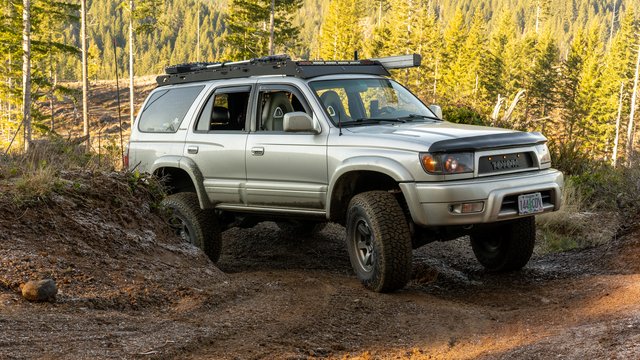

Finally took her out for a proper shake-down!
Me and the dog went to Tillamook OHV to start learning how the 4Runner handles amidst the roots and rocks. I'm glad that I waited until everything in the suspension was at a stopping point because I was not ready for the classification levels they give these trails in relation to ski trails! I stayed on blue squares all day and if that's how they normally are then I don't think I'll ever be attempting black diamonds without some serious encouragement, lol.

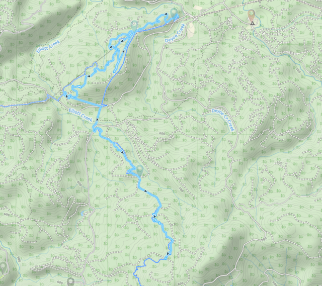

Before I went I mapped all of the 4x4 trails based on the map that [MENTION=637438]LS-4Runner[/MENTION] hooked up into Gaia, but at least two of the blues were either completely or partially blocked due to new logging that's going on.

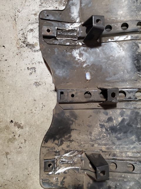

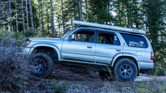

My last run of the day resulted in having to backtrack because of this, which turned into a much more interesting run the second time around; even my awning was getting some abuse! I learned that the stock fuel tank skid sucks, so the RCI group buy on here can't come soon enough. I also think it would be wise to get some shock protection for the back because there were some rock gardens that could easily crack something around the axle.
Needless to say, I'm now hooked! If anyone has websites to share in regards to finding other places to ride then post 'em. Wanna head out on a weekend? SPEAK UP!

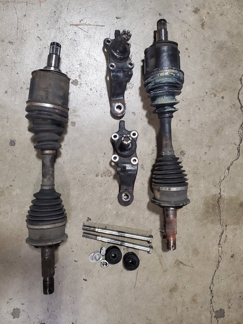

One trip out to the trails and these aging axles took a shit... BOTH of them, lol. I think with having a ~3" lift up front it's time I get some of those sweet CVJ axles I keep hearing so much about. Gave the tires a jiggle and the bearings both seem good. The drivers side inner CV though... well, that rumbling I was hearing the other day is oddly similar to what I could hear when spinning the tire today. Fingers crossed new axles do the trick!

I ended up going with reman OEM axles from Toyota because they were about $180, which would be cheaper than CVJ if I were to eventually put their extended inner boots on... which is what I plan to do with the one OEM axle that came off; the other is a NAPA brand and will serve me better in a dumpster.
Since I had to disconnect the LBJ to get the axles out, I figured that I may as well give myself peace of mind by replacing those, too. From all of the reading I've done, the worn out bushings that these last ones were working with around the front end most likely affected their lifespan, so 35k is long enough for them. They had more play than I felt comfortable with when I had the LCA's off a few weeks back and from all of the horror stories on here I didn't want to chance anything. I'll keep them because after handling the new ones they apparently aren't as tight as tie rods brand new, so the old joints are good enough to serve as trail spares.
The diff drop that came with this truck had to go. The plastic spacers were giving out, so I went with the Sonoran Steel tapered options and they seem pretty nice already! I still couldn't get the torque (101 ft. lb.) dialed in mainly because of the nut moving the counter-hold wrench to a position that was crushing my hand, but I cranked the shit out of it enough to where I feel comfortable with where it's at. That is a weird angle to be at to get that kind of leverage anyway.

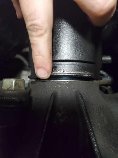

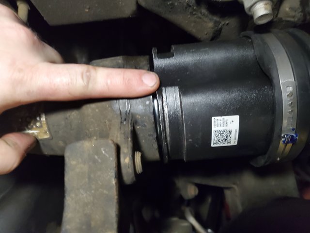

The only thing I'm a little concerned with is the gaps that the new axles have going into the differential. As it is with everything on the internet, I was finding mixed responses. They don't appear to be leaking and I was beating on them considerably with a 4 lb. mallet and stout chisel, so is that good enough? The ones I took out were in further and the dust seal even popped off of one while I was removing them because of how tight it was against the diff. Not sure if that comes with usage or if I need to try to re-seat these new ones to match. What do you guys think?
Passenger side
Drivers side

I thought the spacers that came with the old diff drop gave enough clearance for the stock skid, but I guess I was wrong! Checked the spacers after bolting the front cover down and both freely spun around the bolts; the skid was pressed against the bottom of the diff mounts! Barely had enough of a cutting wheel left on my grinder, but we got it figured out...
The passengers side axle going into the diff looks like it has a minor leak and, like nearly everything I do in life, I found out after the fact that I should've replaced the seals with the axles! Back to Toyota I go!
