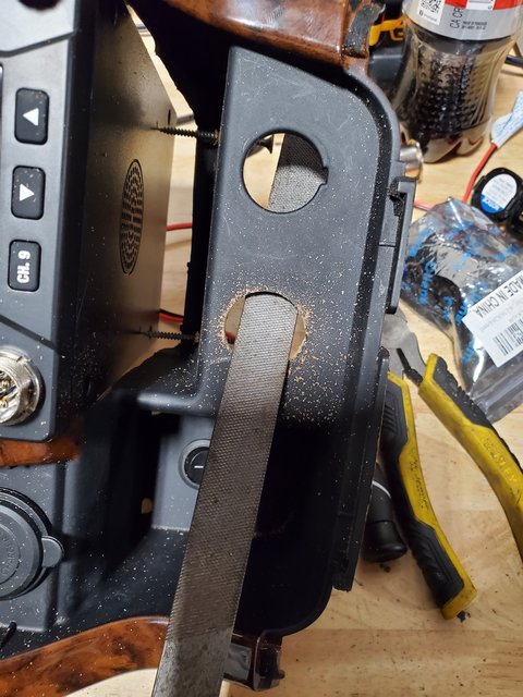

Got rid of the nearing-uselessness 12V cigarette lighter ports!
Amazon.com: Cllena Dual USB Charger Socket Power Outlet 2.1A & 2.1A for Car Boat Marine Mobile (4.2A-Green)
Note to potential modders:
You will need to file/grind out the existing holes. if you go with the most common USB replacements on Amazon. Additionally, you will need to snip the OEM 90-degree connectors off and replace them with standard ones.

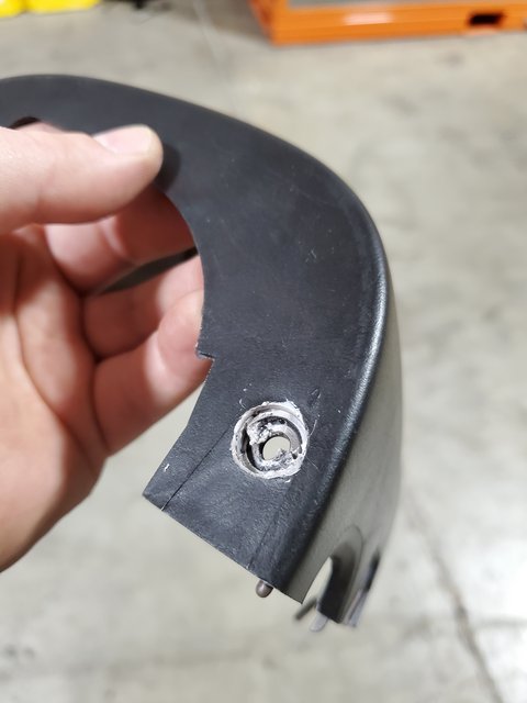

Tried to do what should've been a pretty quick install, but I guess some of the 3rd gen years had to be a little extra about their steering column design! I'm still waiting to hear back from them regarding their thoughts on if I even got the right one because the provided screws were too short and the raised area that was supposed to go into the column's screw recesses was too big. I already took a stab at modifying it and failed miserably, hence my email to them.
In essence, the column is split into two halves: upper and lower. The lower is the one that the Flexpod mounts to with the two recessed screws that are on the front (facing the wheel). In typical "hulk smash" fashion, instead of emailing the manufacturer right then I opted to just drill out the plastic to get it to fit...

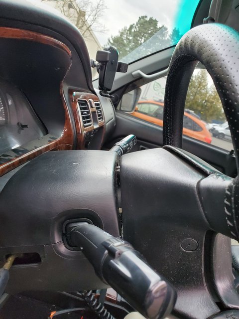

Problem solved, right??? NOPE! The upper half of the column angles back towards the dash ever-so-slightly. Considering the Flexpod is straight up and down, the wheel was now grinding against it. Womp womp!

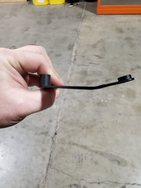

No worries, though! We'll just bend the Flexpod to conform to the column angle...
(the angle on the top column wasn't nearly that pronounced, but I wanted to make sure I had enough and bend back as needed)

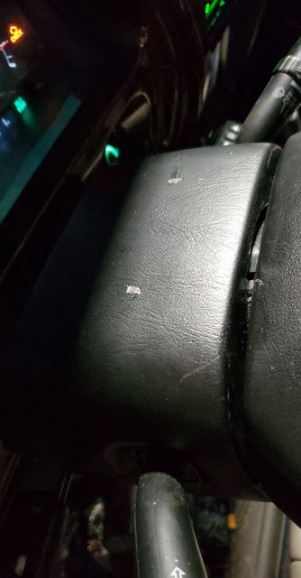

Alright! I fixed it! Oh wait, what's this? The pod bolts are now gouging the top of the column?!?!?!
For how clean this product looks in pictures, I'm not too pleased with the work it apparently takes to get it to work with 3rd gens. The only other person I know who has one said it took some work to get it to not rub... and it still does. I want to like this so bad!!! :crybaby:
In case anyone is curious, here are some extra pics showing the angle on the front of column

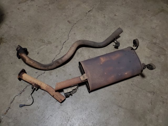

Got rid of the rotted out stock exhaust for something shiny!
The install didn't come without its hiccups, but it was much more intuitive than a lot of other things I've done lately! If you're thinking of doing this Overland Series from Magnaflow, or something else that utilizes one of the hitch frame mounts to mount the rear hanger, be mindful of the design of the bolts and nuts back there. The two closest to the front of the vehicle have the nuts bonded together with some kind of strapping inside the frame, so you have to potentially finagle the second assembly to get the first one to line back up as you hold the new bracket in place. That situation accounted for about half of the time it took to do this job!
I opted to cut out the old exhaust because the rear flange bolts were corroded beyond use. You only need to bolt the front on for the new setup; everything else is clamped. Luckily, the O2 sensor was recently replaced, so that was a piece of cake to get off and back on. The new system lined up very nicely throughout the back and the new cat flange gasket was a nice addition. They say to torque the clamps to 40-45 ft. lb., but didn't say anything about the O2 sensor or cat flange, so I just evenly gorilla torqued those. It's also a good idea to bend out the outwards facing heat shield because I was getting slight contact when shaking everything around. No CEL yet and I've put about 30 miles on it already!
Badass tone through all of the RPM ranges and stainless for longevity. Being mindful of the insulation and carpeting I removed last year to get the Sherpa Equipment cargo base in, the cabin noise is noticeable compared to stock, but not annoying at all. The growl it gives off is muy bueno! I've only had it on the highway for a few miles, but I'm not hearing any drone whatsoever with the whole assembly in place. You have the option to remove the heimholtz tube and cap the elbow, or take it completely off and cap it at the muffler to give you an increasingly more "aggressive" tone. With the entire setup installed, it's aggressive enough for me, lol.
Magnaflow hit it out of the park on this one for our rigs!
