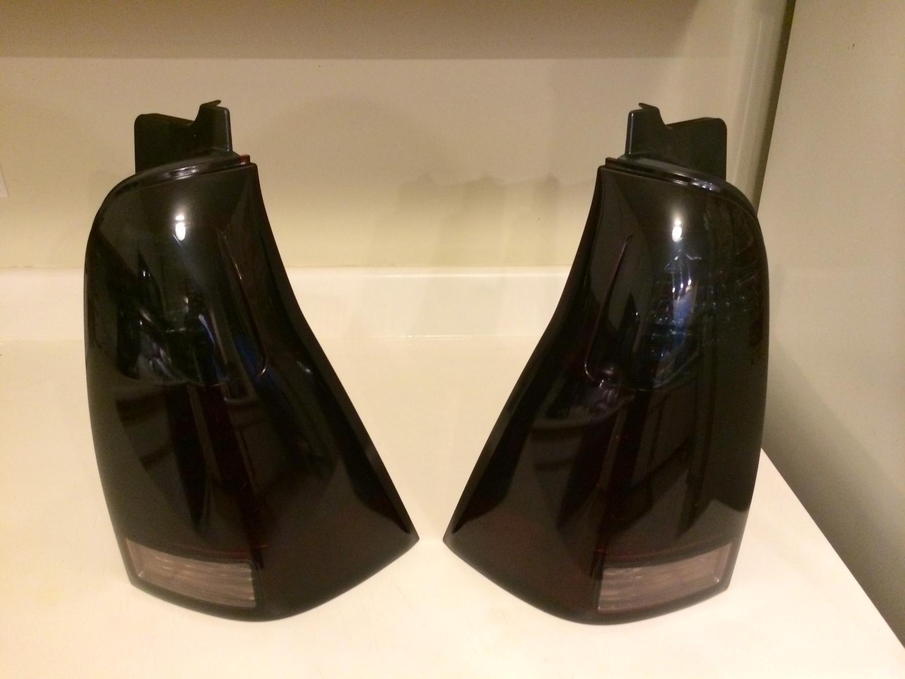

THANKS FOR YOUR INFORMATION!! random question. what product did you use to tint the tail lights? i just plasti dipped my rims and emblems and i like how easy it is to do.

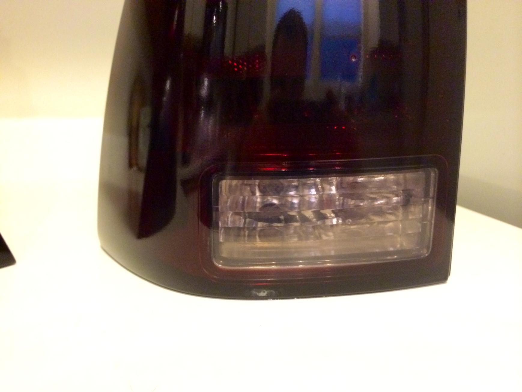

I used VHT nightshades spray paint, Krylon clear coat, 2000 grit sand paper, a black and decker orbital buffer from amazon 28$, Mcguires rubbing compound, blue painters tape(I taped off where the reverse lights are after I did the first sanding, and I used an exacto knife to round the corners on the tape so it looked natural)
This is the link to the you tube video from which I learned from (2parts)
https://www.youtube.com/watch?v=OSKA0ElKg1Q
https://www.youtube.com/watch?v=-8-hZP6-ZY8
I would also recommend just 2 coats, not 3 like in the video. That's what I did and it's plenty dark with just a slight hint of red
