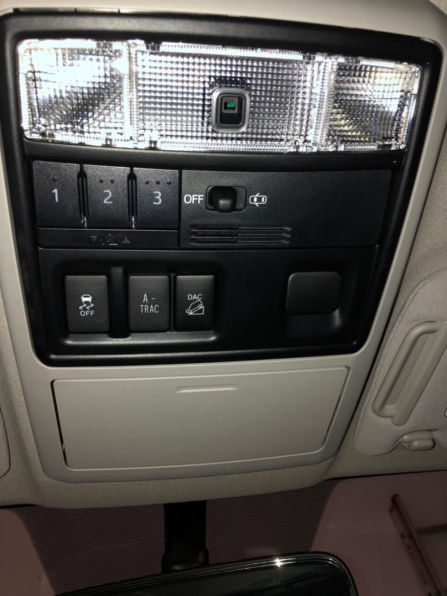

If you don't mind my asking, how much did you pay for this? I also have the cheapo SR5, but I swapped the overhead console for a factory SR5 Premium console with the integrated homelink buttons. It was about $170 delivered and only took about 5 minutes to install.

114 is what I paid. Also bought it because my wife's new Corolla XSE doesn't have homelink and I thought that I could use it on her car if it doesn't work on mine.
Where did you get the SR5-P overhead console? I've looked around & not finding one as pictured, only the $1000+ version. If you have a part number please include!
It's Toyota PN 81260-35601-B0; just order from your friendly Toyota Parts Department of choice.
