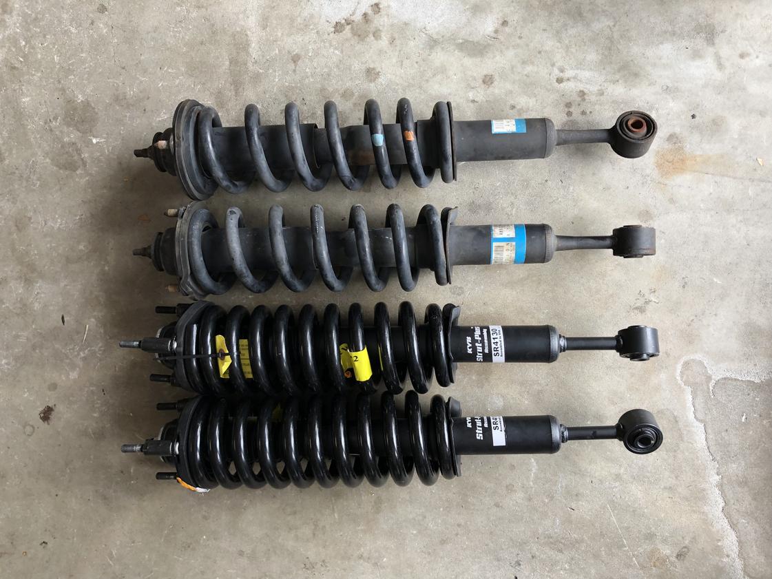

Thought I’d update this thread. The KYB struts I received are the same exact length as my OEM struts.

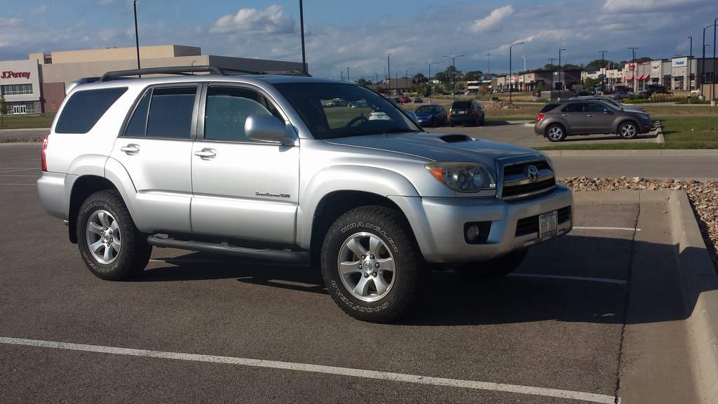

i just did all 4 KYB shocks on my 08 sport, for the first couple hundred miles there was about a 2.5" lift in the front, that has settled to about a 1.75-2" lift measured from the ground up to bottom of fender centered on the wheel. it had a worn out xreas so im not sure how much higher than stock it is but sits close to level now with no spacers.
KYB says the springs & shock valving are about 10% stiffer than stock, so far im happy with the ride & small lift of the front. 265/70 tires.
thanks firebirdguy!. Appreciate the picture. It helps knowing that these eventually settled level, with no spacers.

my xreas shocks werent blown or leaking, just worn out at ~140k miles & the springs are what were sagging to make the front sit lower. heres a pic a couple days before installing the KYB's, same tires but you can tell the front was much lower, after about 4 months & ~1500 miles they have settled at what you see in the above pic, its not level but the front is much closer to the rear & for not using spacers or spending a lot more on billsteins im very happy with the ride & stance.
