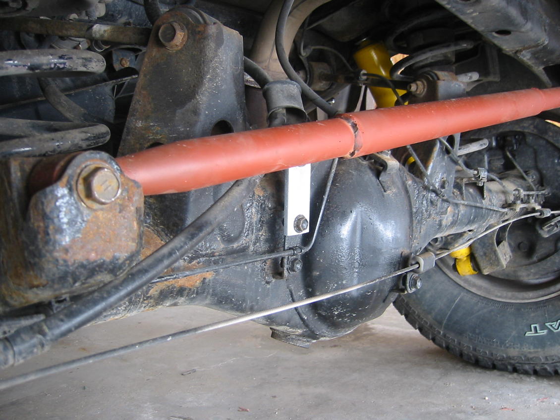

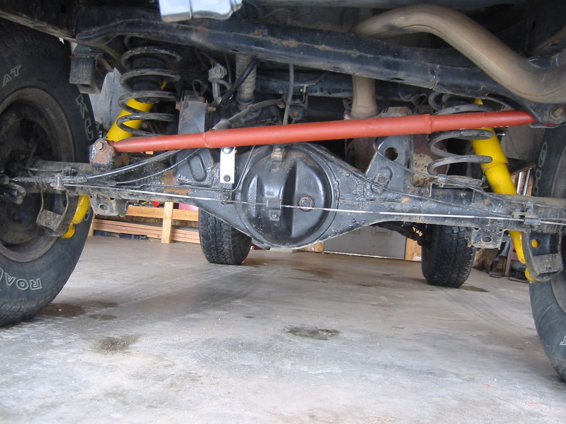

Yeah but you don't need to by the adjustable bar. Just go buy a $6.00 piece of 1.25 I.D. pipe and extend yourself. Beats the 175 dollars to adjust your bar a whopping 3/16 of and inch
So ryani when are you doing your panhard drop? I post the pic that you can make it your self.
I didn't drop the point of attachment I lengthened the bar itself. Like the adjustable bar does I just made it permanent.

Here's the pics of my lengthened panhard bar. It's been painted a nice shade of primer red. Didn't have any black paint in the garage. haha. Notice it's just a tube with the same inside diameter as the outside diameter of the bar itself.
