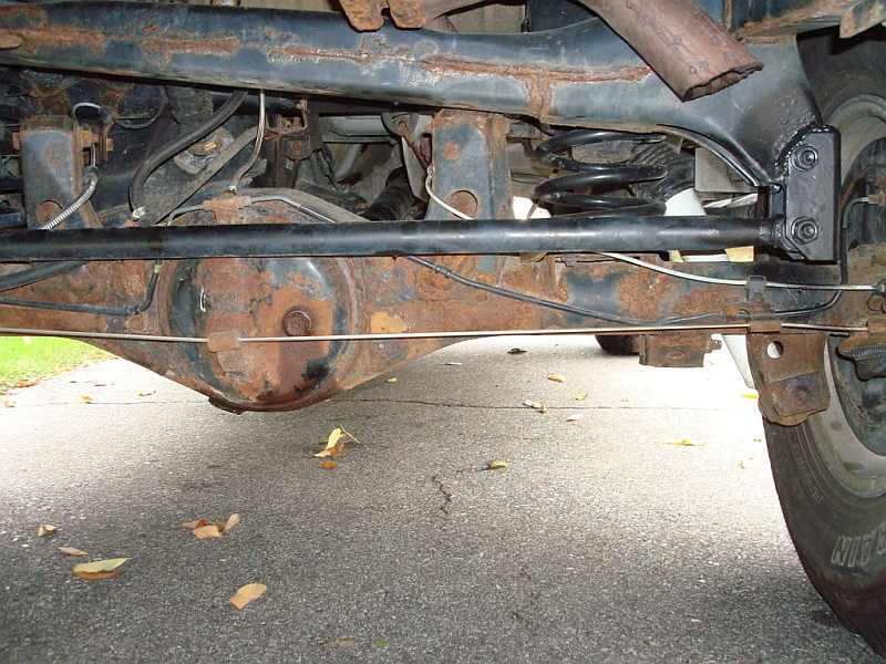

Extended panhard bracket
Courtesy of Brian: Your idea of extending the bracket.

Your 4R rear axle is pull to the right when you lifted it. That's why we are concerned to get the axle back to the right place it was...
