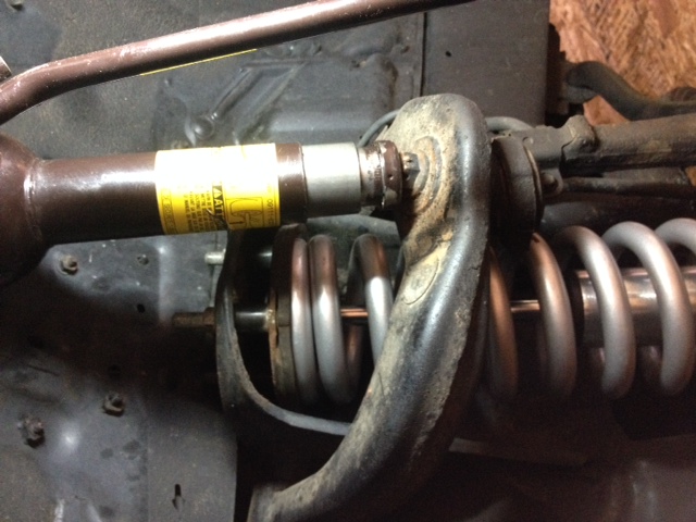

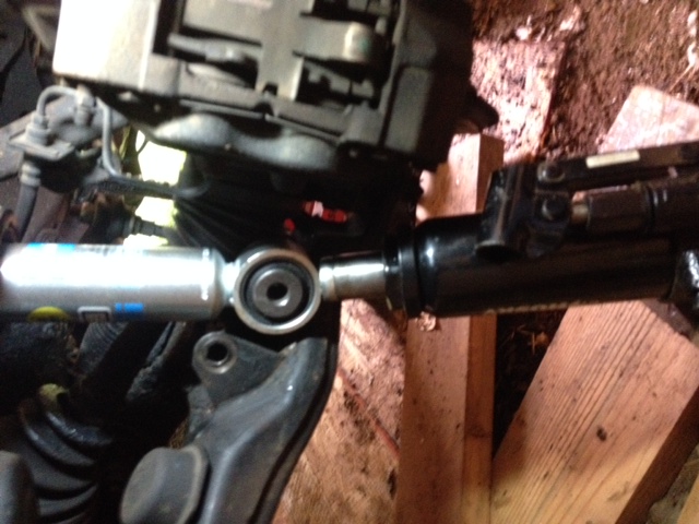

After months of waiting on backordered Bilsteins, they finally came in.
Tundra Adjustable Bilsteins (5 settings of adjustment) paired with Toytec/Eibach coils (112-620 Toytec/Eibach front coil lift springs for 4runner).
Worked today on removing factory coils/shocks, compressed, and reused top parts with new shocks and coils.
i set the shocks to the center perch (3rd from the bottom--right in the middle). i bolted in the top 3 studs, and then used the bottle jack method on the upper a-arm to get it to droop to fit the new shock.
here's where i'm at:
i can't compress the upper a-arm any further or it makes contact with the coil and acutally prevents it from going in where it should
and the bottom of the shock is still this far away:
i have tried prying with a crow bar, jacking up under the shock to get it to compress up and in, and nothing works!
what are my options???
please help!
p.s.
sorry the stupid pictures are sideways--apparently nothing is working for me today. :ybrick:

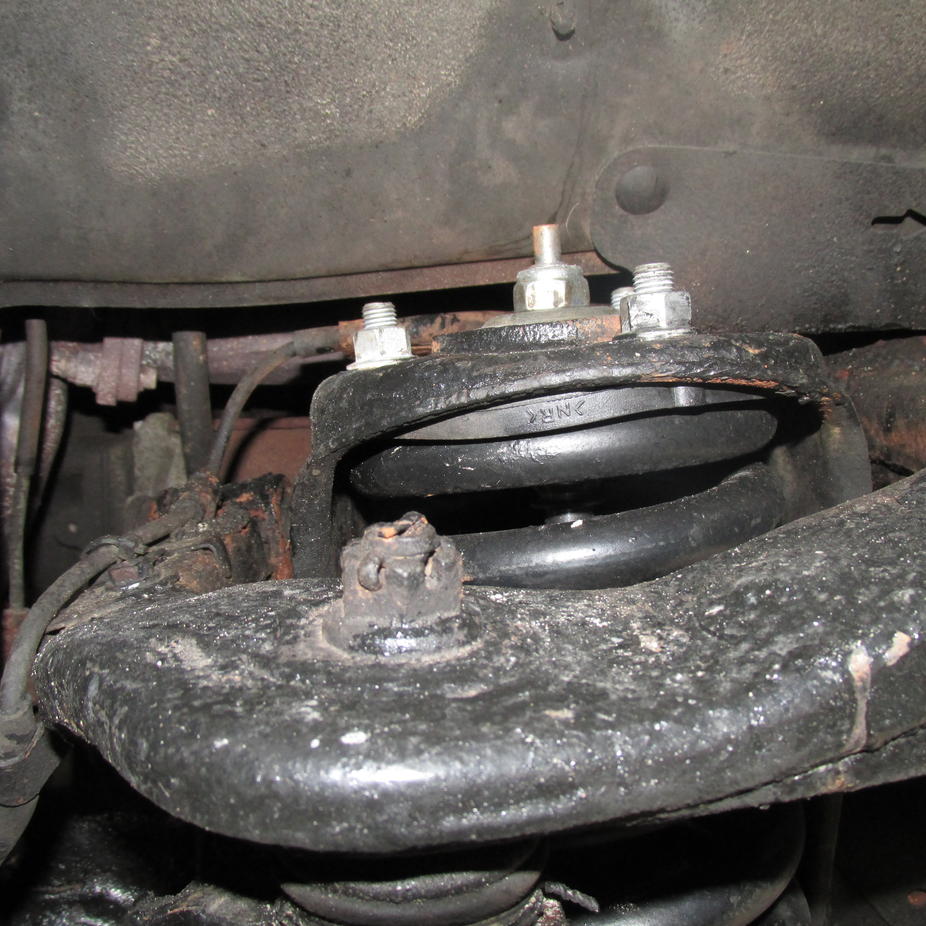

One other thing. Maybe a stupid question. The 1st picture shows the top of the coilover in the UCA. What is between these 2 components? Is it just loosely bolted in with the longer studs from your spacers?

i got it aligned again (after i lifted it from the spacers to the new struts). and it made no difference in the vibrations at 60 mph. i only drove it 50 miles between lifting it the second time and aligning it. and it started vibrating right away after i had lifted it the second time.
they didn't put longer studs on it for the spacers--the three nuts just went through the coil spacer. those three nuts just tightened to the upper bracket the same way. unless i'm losing it? they are nice and tight without any play.
Mine doesn't look like that. The upper hat is recessed into the UCA.
