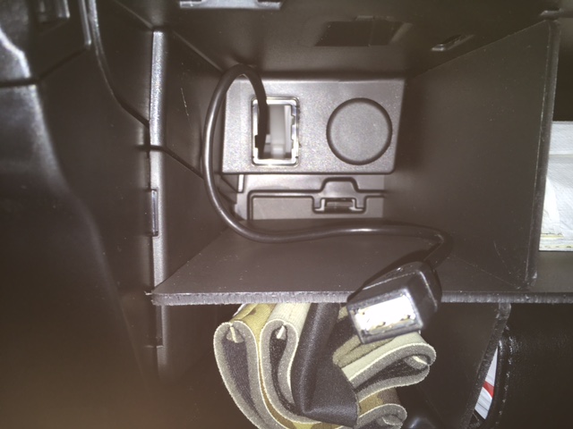

USB: The Kenwood comes with a USB cable that has 1 plug on one end (plugs into the head unit) and 2 standard female USB plugs on the other end. One of those plugs is designated as the smartphone plug; the other is for a USB flash drive. I plugged the smartphone USB plug into the factory USB port that is on the center console (the one with the Aux plug and the USB plug). I used an adapter for that (more about that further down). I plugged a standard Apple Lightning cable into the console USB port, which is plugged into my iPhone. This makes it easy to reach the cable to plug in the phone.
For the USB flash drive plug, I don't plan on using it often. I ran the cable from the head unit into the glove box. There is a panel in the glove box that has a couple of pop-out blanks (I think this is where the USB port and 12v "cigarette lighter" plug was installed in earlier 4Runners). I popped out the USB port blank and ran the Kenwood plug through there. Picture below.
USB adapters: Crutchfield automatically added the Metra AX-TOYUSB2 to my cart, saying it was the correct part. It is NOT the correct part. It does not bridge the gap between the female end of the Kenwood plug and the factory proprietary plug on the backside of the center console USB plug. You need the Metra AX-TOYUSB (notice no "2" at the end of that part number). Luckily, the correct adapter is included with the Maestro TO2 wiring harness.
