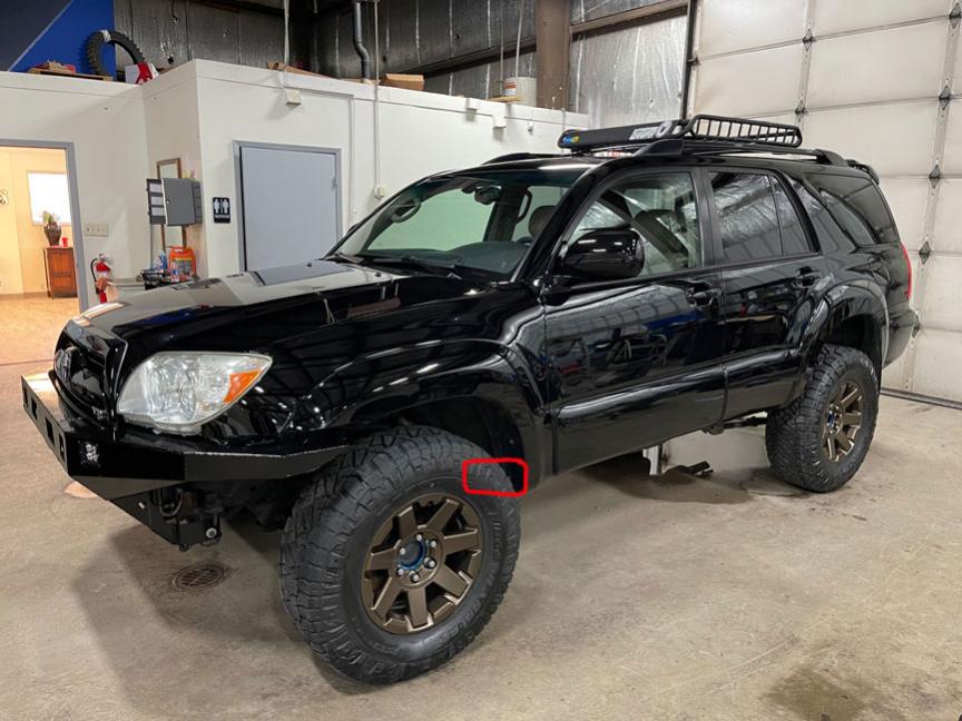

Hate to threadjack but newb here and can't make my own posts yet. I also just bought a 4Runner (2006 V8 Limited 4WD).
My suspension needs some work though, and I need some advice. Pls advise where can I post this? I'm getting significant tire rub in red area posted about 70% of full lock on turns, especially acute changes in terrain levels, bumps, turns, etc. Hitting body mounts and plastic from corners of tires.
Have following specs:
Coastal Steel front bumper (~120lbs I think)
Bilstein 5100's front (2.5" lift) and rear (unsure of lift setting)
Bilstein coils / springs in the back (B12 heavy springs)
OEM coils / springs up front
285/70/17 tires (32.8" diameter)
FJ 17" Wheels with 1.25" Spidertrax spacers
JBA High Caster Upper Control Arms
I feel like I've read lots of posts of people running these tires no problem, not sure what I should do to fix. Was considering some OME 886 coils in front on 0" Bilsteins to achieve more lift. I went to alignment shop and asked for as close to 4° caster as they could give me but they basically lowered them both :rolleyes: I'm at 3.3°L/2.77°R and getting pretty bad rubbing. Was hoping to make this thing at least somewhat capable offroad, and at least driveable on the road lol. What else can I do, or do I just need new / smaller tires?

First of all nice rig. Looks great!
you may have good luck posting here:
4th Gen Suspension Options/FAQ
I would suggest looking through that thread. But I have quoted the relevant info below. You probably are running about a 2.5/2 lift in the front due to the added weight so it seems like you will either have to go down to 275/70/R17 tyres or look into getting a body mount chop and/or stiffer springs. It's really up to you and based on what you want to use the truck for.
I am not a suspension expert just going off the info I saw looking into 5100's on my car.

Looks like further lift via stiffer coils in the front and/or body mount chop might be on the table. Replacing the old OEM is something I'm interested in doing, does anyone know if Old Man Emu 886 coils have any issues with Bilstein 5100s?
I do not see any reason why it would cause an issue. Should work fine but look around the forum if anybody has run that combo. If you are concerned you can always stick with bilstein products and contact them to ensure fitment. I know bilstein makes some heavy duty coils.
