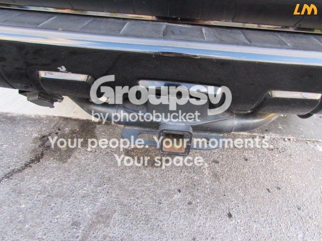

1.png~original
Here is the Pic of the 4Runner that I was going to buy.
Q1: Is the 06 V8 4runner okay to tow the racecar. Sure why not
Q2: do i have to look for any specs on tow package. shouldn't have to
Q3: Do i have to look for any transmission cooler if the car is equipped with or not. If not how bad is it for my towing needs. I would suggest getting one if there are any hills whatsoever pulling that heavy of a load (you're at the rated limit pretty much for the 4Runner). B&M makes great coolers, check out JEGS for fast free shipping and good prices.
Q4: what are the pre-requisites that I have to be aware of before towing my 5400lbs on a 12hr drive to the track. (um, nothing, hook it up, lock it, and connect the electrical...)
v8's have a Weight distribution hitch like the one you have pictured... might already have an aux tranny cooler as well not sure (if not, you can buy one and install it easy enough)

Weight distributing hitches are found on the trailer, not the vehicle let. What's pictured is a frame mounted receiver, as opposed to the one that is just wielded to the crossmember
That's a hitch that can be used with a weight distributing system, but yes, it doesn't distribute any weight without additional parts. The hitch that comes on the V6 should not be used with a weight distributing system. There are a bunch more parts needed, including a trailer that's set up for it, the weight distributing shank and head that replace a normal ball mount, a pair of spring bars, and sometimes and anti-sway system. I don't think any uhaul trailers are set up for it, but I could be wrong. Just aim for 10% of the trailer weight on the hitch, so about 540lbs in this case. If you have less the trailer could go out of control, and if you have more without a weight distributing setup it will put too much weight on your rear suspension making it more difficult to control the car. The max payload for the truck is around 1200lbs, so with the trailer attached don't put more than 660lbs (including people and cargo) in or on the truck to stay within the weight limit. If the actual tongue weight is higher, you have even less cargo capacity. But it's probably better to go over the rated payload/GVWR rather than under 10% tongue weight if you can't meet both requirements. Just make sure your tires are properly inflated.
