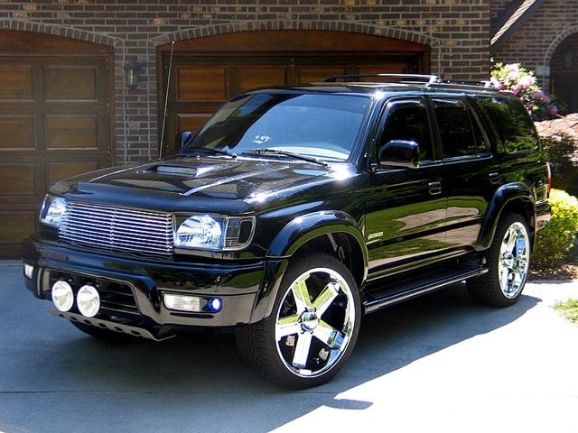

I am working with my son on his first vehicle purchase. We looked at many pics from this site and he likes this look. I prefer the blacked out offroad look, but he and his mother win this round.
Anyway, I have some questions on how to get there.
So I think that is a 4th gen sport model.
Custom grill
Custom headlamps?
Custom tires and rims (what size are those? I'm not well versed in wheels)
Lifted slightly or just leveled?
Anybody have this look in silver, or in a 3rd gen? Is there any reason to avoid the 3rd gen, other than I would like him to have side airbags?

Thats a third gen. And your going to get alot of hate from this forum with that. This is more offroad intended. About 99% of us think that looks like complete crap. Also think about those rims a new driver hits pot holes and curbs more often and will be less careful so your more likely to be dealing with bent rims. My first car had rims with low profile tires and i was always bending a rim. Also alot of those vehicle like that have alot of cheap things just thrown on or together for looks. But everyone has different opinions.

I thought the hood scoop was a 4th gen sport model. The front looked more like a 3rd gen but I am not sure.
I agree I may not want that low of a profile for the same reason you mentioned, but I think I could get similar with more standard sizing.
What about the lift amount?

This is a 99-02 3rd Gen Highlander or Sport Edition.
From what I can see:
- big wheels. 20"-22"
- possibly lifted/leveled
- factory skid plate
- aftermarket fog/driving lights in lower grille
- HID's in factory projector fog lights
- aftermarket headlamp housings with HID bulbs
- aftermarket (probably billet) grill
- bug deflector
- maybe a hood scoop insert
- radar detector
- black strip across the upper windshield
- dark tint
- vent visors
That's about all I got, and should do the trick for you.

I like the look of yours with the 2.5/1.5 lift. I assume the pic I posted is more than that due to 20+" wheels. I don't like the idea of spacers, so that pushes me to lift coils and shocks. I think I saw a kit online this weekend for $700, just can't remember where (adjustable Blistens?) If I go with the Blistens, I can look at SR5s in addition to Sports cause they will improve the ride also?
That keeps me at 17" or 18" wheels, depending on tire selection for no rubbing. This will be more of a DD so I shouldn't have the big sidewall Off-Road tires.

No problem. I appreciate the compliment. I don't think that the picture you posted is more that 2.5" lift. You can actually fit up to 24" wheels on these trucks with no lift. It's all about tire/wheel ratio. Wheel size goes up, side wall height decreases. We've got a very active member (riceandpho) with a 4th gen on 22's and I'm pretty sure he doesn't have a lift. You can use fitment guides on tirerack.com to see what fits. I needed a lift to fit mine because I went up in overall diameter from 30.5" tires on 17" wheels to 32" tires on 20" wheels when I had my 2.5/1.5.
I really wouldn't rule out the idea of a spacer lift/level if you're looking to lift. They'll save you a lot of money and doing a full suspension upgrade is overkill if you're not going to use it off road. The factory suspension is very sufficient for daily driving and spacers will not affect your ride quality. Drive one and you'll see. You may be talking about the Toytec/Bilstein lift, but $700 is a killer price if so. Even so, you're talking $700 vs. $150 for a Daystar 2.5/1.5.
As far being able to look at SR5's as well as Sports, I assume it's because you're interested in the X-REAS. Yeah, do one or the other, if you're set on upgrading, just get the SR5 and forego paying extra for the Sport suspension. Even if you did get a Sport, you may find that you scrap that system for a traditional aftermarket system eventually, depending on it's age. But you mentioned being interested in side air bags and I'm not sure if those are standard on any models or optional on all of them, but you may find them harder to find on SR5's... I'm not sure about that one, but I don't think mine has them... I could be wrong.
Also, a more generous side way will offer you more protection off road, but it also can yeild a smoother ride on road. A smaller side wall will improve handling on road, but offer little protection off road and will provide a rougher ride on road.
