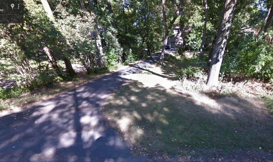

This is my driveway which I back up into every day. Extra light at night would help a lot. But I'm not really wanting to add extra accessory lights if possible.

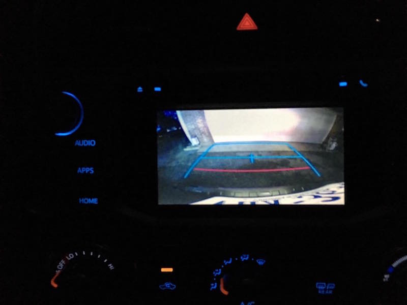

Here's what they look like in a well lit parking lot, they provide more than enough light to see through the rear camera.

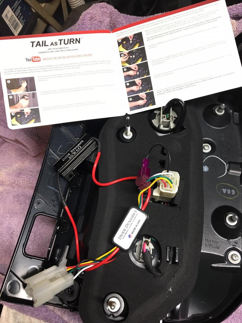

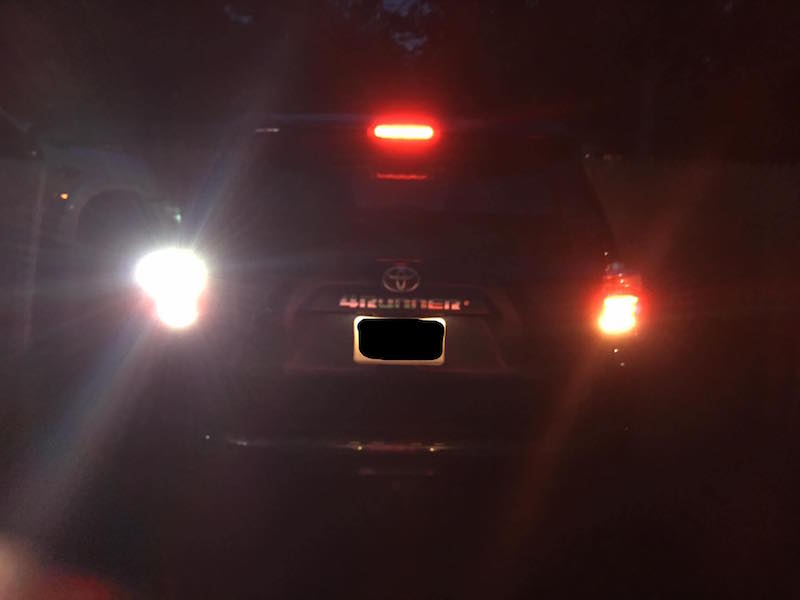

I pulled the trigger on the DD kit during their black Friday sale, and after waiting 5 weeks to get it, I finally found time to get it installed this week.
I had already upgraded the factory backup light position to the Phillips 921 LED lights, but all that really did was make the light more white, it really didn't give me any more usable light. As you can see in the pictures, I now have a lot more usable light. And as the previous poster said, the light from the old turn signal spot is more dispersed, which is exactly what I wanted. When I back up my driveway (see post #23) I really want to see the sides (trees) and ground more.
So far I'm very happy with my $100 spent.
*These were taken in a dimly lit parking garage. I'm going to try to get some in a completely dark garage too.
--New light on passenger side, old setup on drivers side
--Old setup
--New setup
