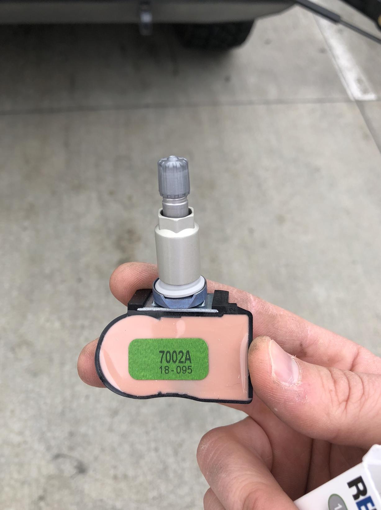

My limited has one for the spare. If I don’t have one in there the tpms light will come on... just replaced it yesterday.
