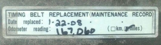

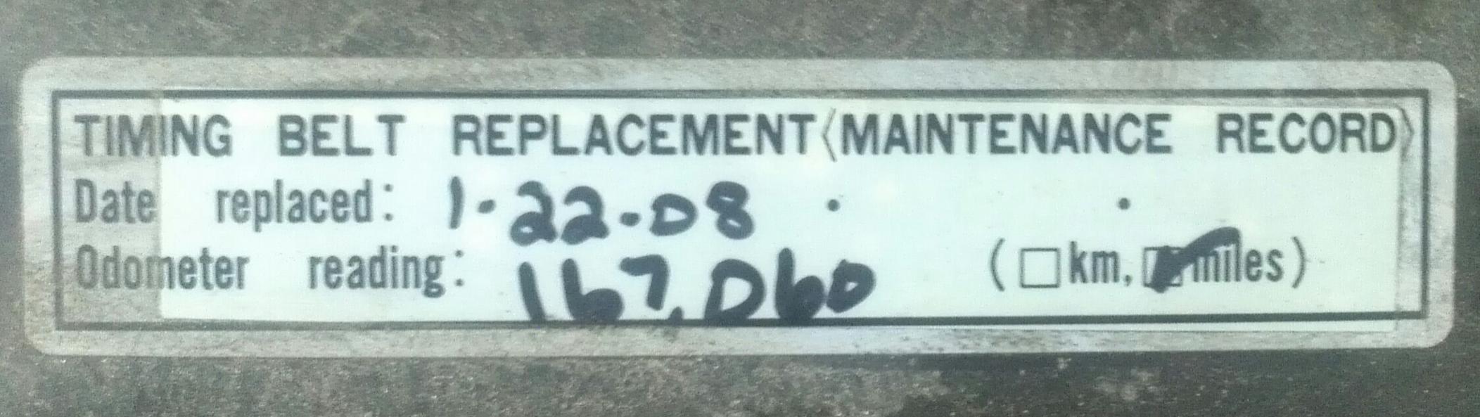

Have you check the Timing belt? Toyota's use timing belts and it needs to be replaced every 60 K miles along with the water pump, cam and crank seals.
You might want to drain and fill oil and replace filters.
What is the mileage in your truck?
@thor and nissanh, you bring up good points. she's got 142000 young miles. it was one owner and had a carfax. they took it to a toyota dealership which is great, however they dont have a record of replacing the timing belt. it would be rare for a runner to go 140000 without one right? what should i look for in a failing TB? i also put gas in it for the first time, so im hoping that i didnt screw the cap on tight enough. The lights have not come back on yet after a day of driving and i know im not completely out of the woods yet, but hopefully its something minute. thanks for the input.
See if you can find something in the engine compartment.
