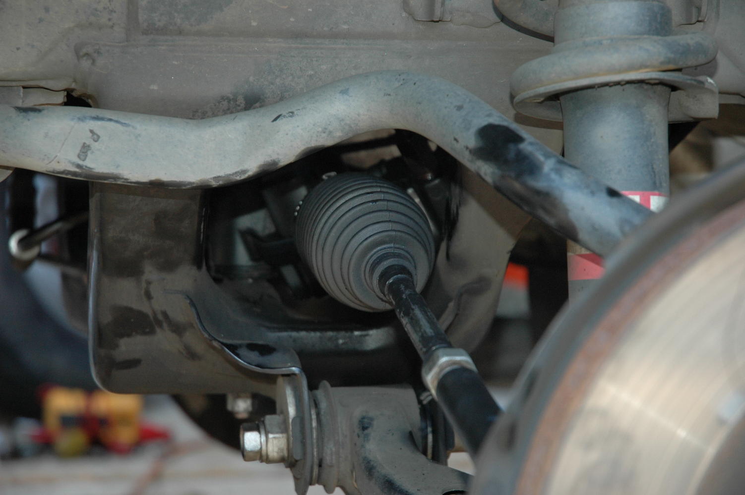

I don't have pics of the old one. I was messing around with the camera when he had installed the new one.
Had I bought the part from Toyota, it would have been $1,300
