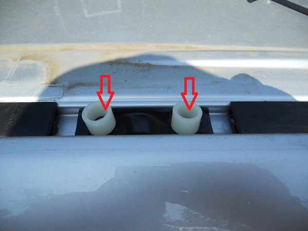

Here's a pic (originally fom Reata) of the Gobi mount tubes. These tubes go over the holes in the roof and have sandwiched rubber gaskets that seal the holes. Many people fill these tubes, and the area around them with silicone.
That said, if you install the Gobi correctly you shouldn't need any silicone. I didn't use any for mine and have had zero leaks, and it has been through hurricanes :bluejump:.

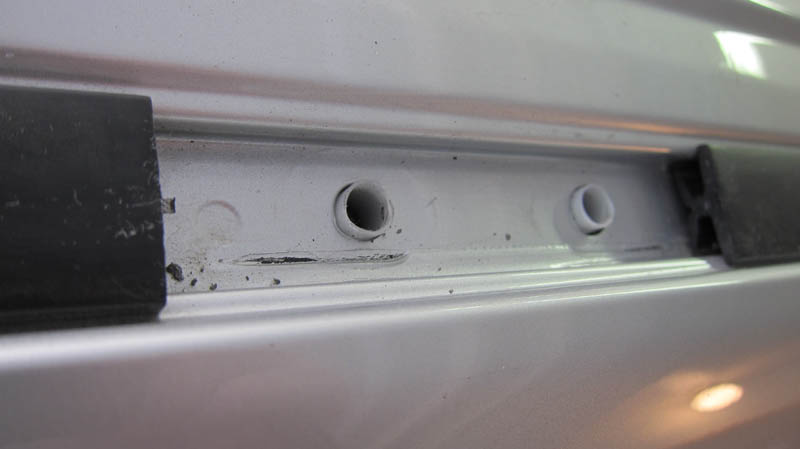

Pictures are as follows:

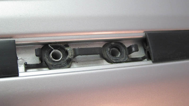

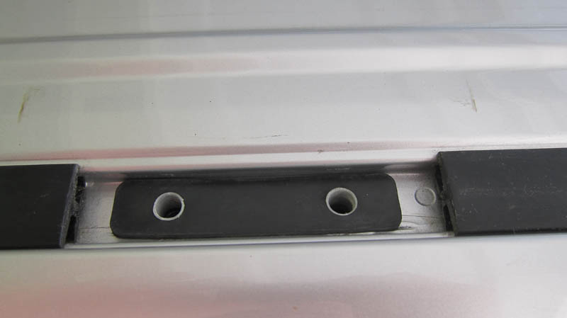

1. Stock 4Runner (2012) Trail Edition roof rack mounting point (4 of these around the truck with 2 bolts each)
2. Underneath the stock mounting plate and bolts is this thin gasket. Also shown are the two white tubes everyone is concerned with that allow leaks
3. Mounting area mostly cleaned, gaskets removed (trash), and white tubes remaining. These white tubes extend only slightly above, and seem to extend down into the roof where the internal nut is located

Next in mounting the ARB mesh roof rack (long version) is to place their provided rubber pads around the white tubes in the mounting area (first picture below). Before I placed these, I used clear marine silicone to seal around the edges of the white tubes and roof metal.

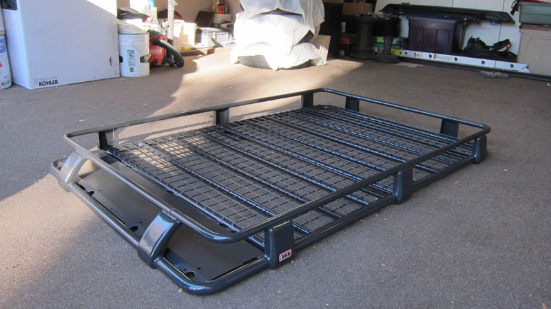

Then a picture of the ARB mesh roof rack..

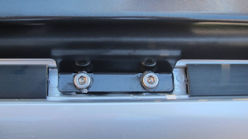

And the third picture shows the ARB mounting rail installed on the mounting area. Note that the ARB install instructions actually mention (optional) application of the silicone inside the white tubes before inserting and tightening the mounting bolts (which I gladly did).

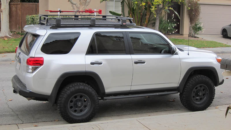

And finally, with the ARB rails installed on the 4Runner and the mesh roof rack attached to the mounting rails (what a pain in the a**!).
Observations:
-The ARB rack is real solid and I swear the truck feels stiffer with this thing bolted on.
-MPG is down about 1.5MPG.
-No added wind/road noise that I can detect.
-Color on rack matches wheel color (mostly)
-Sunroof still slides open/close automatically without interference
-Sunroof tilt does work, but I always stop it before maximum "open" just in case it hits and does something it shouldn't
-I tried the ARB K6202 Hi-Lift/Shovel mounting bracket and didn't like it as it didn't feel secure or seem to be a great match for the rack (FWIW)
Also shown in the FourTreks alum. Hi-Lift mounting system (awesome product) and 48" Hi-Lift (with basic cable lock).

To set things straight - the white tubes in your pictures are not the same as the ones I posted (they are the same ones as in Okki's pics, however).
The tubes I posted come with the Gobi rack and are part of their mounting system.
Just wanted to make that clear. Nice rack!
^^^ Thanks Antman!
Regarding the white tubes: Do the Gobi tubes slide over/around the existing white tubes, or replace the existing ones altogether?
^^^ Thanks Antman!
Yes, the inside diameter of the Gobi tubes are the same as the outside diameter on the original tubes. They slide over them on top of a gasket.
