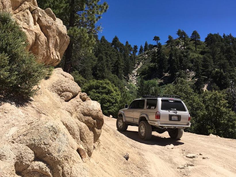

Looking good on Clark's Grade the back way to Big Bear, CA

Masson74, what paint did you use? Is it a close match to the truck (hard to tell in the photo)?
Ha Ha. Rostoleum silver metallic wheel paint. It looks good from about 15 feet. I am eventually going to powder coat it once I get my tire carrier from Roy. Don't be too impressed.

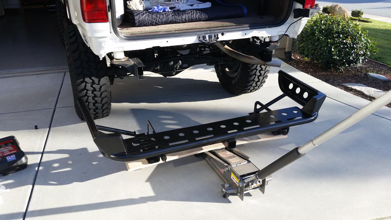

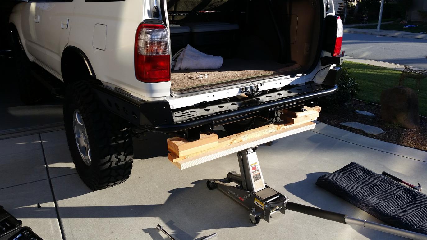

Installed mine today after getting it powder coated last week. The fit and finish of Savage Off-Road's work is absolutely spot on. And fantastic welds. I am extremely happy with this product as well as their Rock Sliders I previously purchased. FWIW, measuring to the bottom of the fender well, I compressed an additional 1/4" on the rear running OME 890 springs.
As a point of interest regarding my spare tire. After I installed a 2" body lift I had the factory spare tire elevator cut, raised 2" and rewelded higher so everything including the crank handle still all lined up. I slung a 255 mud tire under there and it fit very nicely (only just barely though) with the factory bumper. Unfortunately this no longer fits with the new Savage bumper due to the crossbar being further inward (forward). I expected this most likely would be the case and it just means I will need to order their spare tire carrier sooner than I planned.

For anyone putting this bumper on in future. You don't need a jack. The bumper/plate will sit on the back/top of the 4Runner frame. Makes it one man job very very easy to install. The frame is like a little support.
Looks good though mate.
