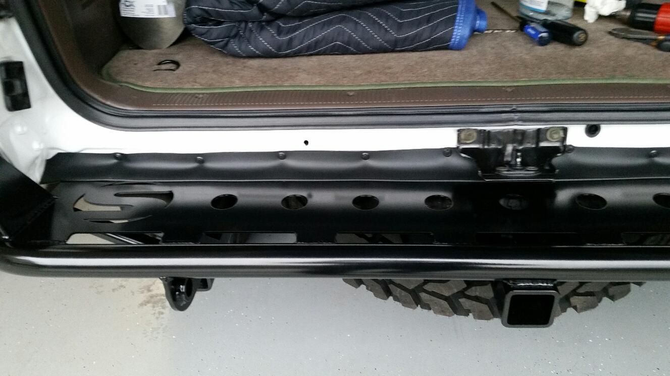

So once you remove the rear factory bumper the plastic molding no longer works with the aftermarket bumpers... I didn't like the idea of the bottom edge of the rear hatch being exposed like that so I decided to close it off. I looked around for some narrow rubber strips of some kind but couldn't find any at the usual suspects stores. In the end I bought the cheapo vinyl bathroom baseboard material and cut it to fit. 30 minute mod job. What have others done?

Nice work [emoji1360] I completely agree with you; it looks unfinished without something added to close the gap.

Thanks yes it looks unfinished with the gap there. It's pouring buckets here in Cali today so this was just something to kill time. It actually looks much better and quite clean in person, for some reason the picture looks a bit shitty. It shows shadows that aren't actually as prevalent so while the screws do cause some creasing on the vinyl it isn't actually very obvious except in the picture. I will keep looking for proper rubber strip though as I am sure that will at the very least, feel proper.

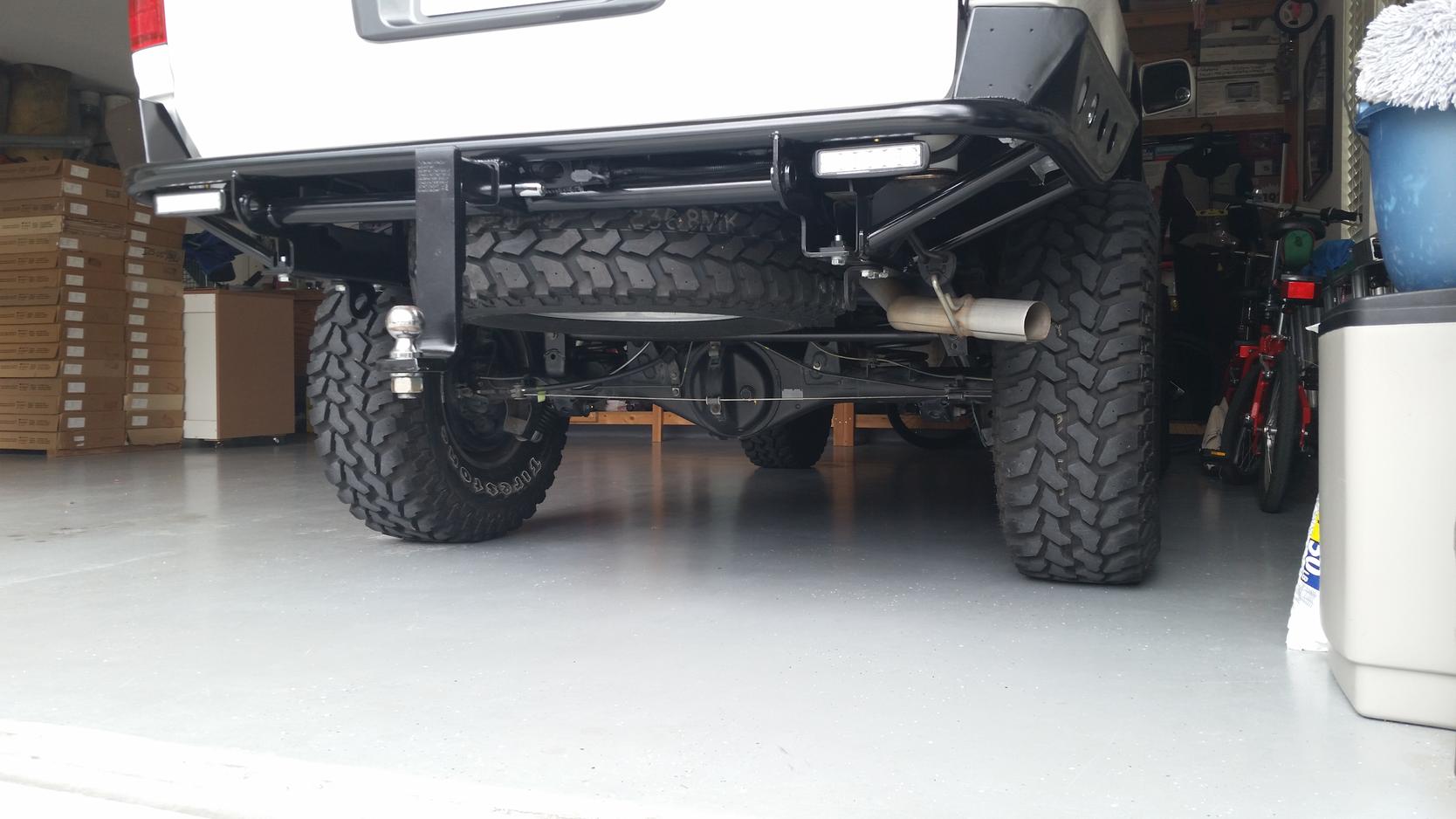

I added these rear facing LED's (18w each) to my Savage bumper. Also picked up an 11" drop bar for towing. My rig sits 7" over stock between the lifts and tires. Add in the higher receiver point in the bumper over the factory hitch point and it required a pretty deep drop bar.

That turned out really well. Was it hard to mount the lights? Are you planning to get a swing out?

Thank you yes I'm happy with it. The lights required a little bit of engineering to mount bcs the bumper doesn't come with light adaptation. But it wasn't hard to figure out a way and it came out clean. The wiring connections are soldered and I bought heat shrink tubing from Harbor Freight which is cheap enough that I shrink wrapped the entire length lol. Ran the wire into the cab above where the spare tire hangs, then under the carpet through to the engine bay and direct wired them so I can turn them on anytime and not necessarily as reverse lights. The access points under the tailgate worked for my CB antenna wire so I was already familiar with the rubber plugs under there above the spare.
I do plan on getting a Savage tire carrier but down the road after I get a front bumper and under armor. I don't mind my spare tire under there and haven't drug it yet. It's a 'pizza cutter' size at 255/85 and I also cut and re-welded the factory spare tire elevator raising it up 2" after I added the 2" body lift. So it's decent clearance for now. But yes, not permanent. I have a daughter away at college so I have to watch my burn rate for my hobbies.
