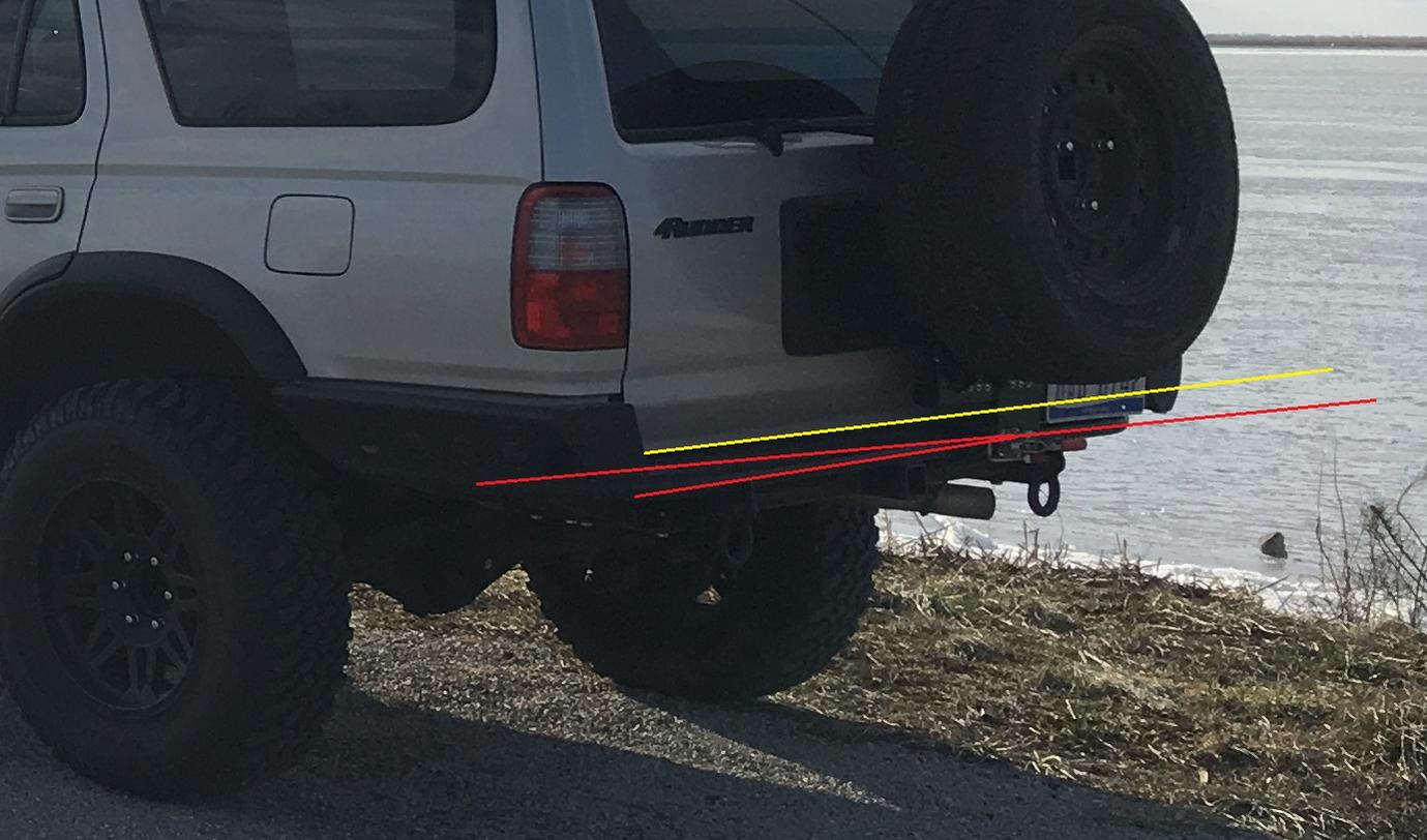

Then the build quality is inconsistent. You can literally watch my bumper deform under the weight of the swingout while latched & driving. The red handle is adjusted appropriately. Everything is torqued.

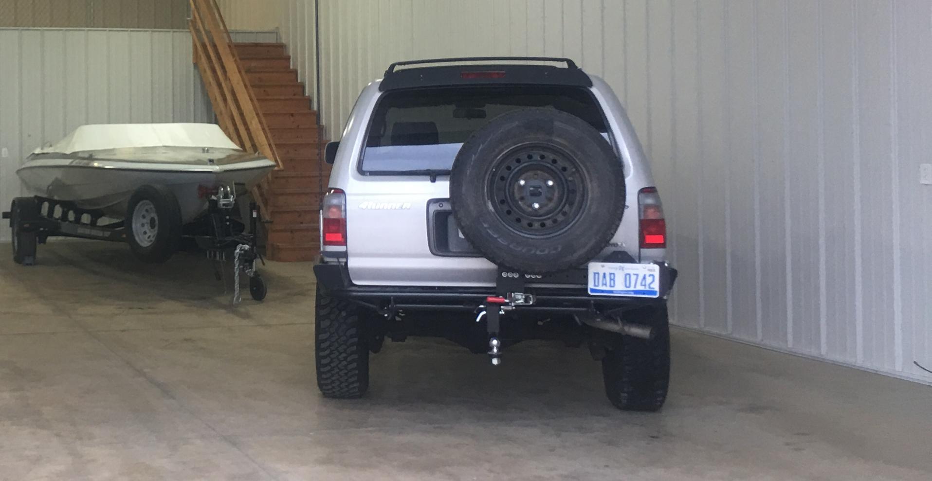

It's in storage right now, this is all I have. The right half of the bumper sags under the weight of the swingout while stationary. It wobbles in this way while driving.
Yellow is aligned to body, red is aligned to bumper.

Yeah, I could see the gap before I even looked at the last photo. Nice touch with the lines.

I need to get in touch with him. I kinda assumed they were all like this, but it sounds like that's not the case. Here's another terrible example pic if anyone else is having this issue.

I found some photos of mine.
To my eyes, it looks perfectly straight.... and i am sorry, my handle is the same way....
