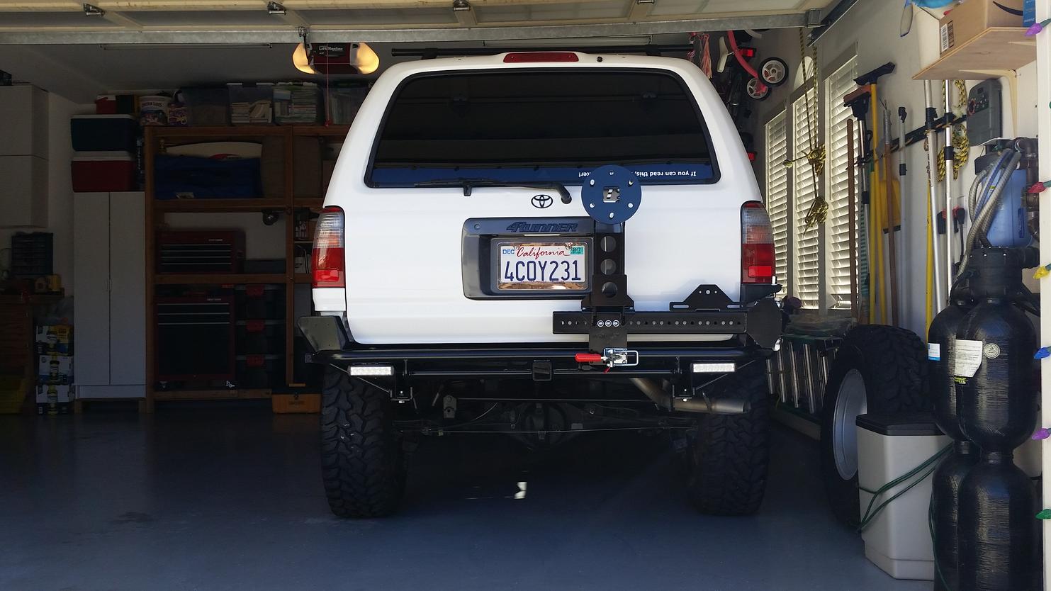

Finally got the rear tire carrier installed. A year to the month since installing the rear bumper. So far loving the finished Savage Off-road product once again. I hope I don't get bumper droop one or two guys have mentioned, I'll be looking out for it but I run a pizza cutter for a spare so a tad less weight than I've seen some guys hang off of it. We'll see, fingers crossed.

You'll be fine. I'm hanging 90lbs off it with my tire and rim combo. I have been for months. I've wheeled it hard enough to expect it to break. It hasn't moved.
Man, that is one clean looking white 4runner. That new swing out looks great too! Great choice.

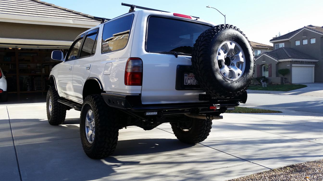

With the tire mounted. Not going to lie it does wobble very slightly and I expect that since it is a tower design and no top brace. How about you other guys with the carrier and those huge spare tires. Do yours wobble or did you figure out how to control that?

Are you talking about a noticeable wobble in the vehicle while driving or just the tire moving slightly? Mine moves a bit but I can't feel it at all while driving. My latch setup is pretty much identical to your setup.
i notice a little wobble hitting large bumps but it settles quickly
not much movement with normal driving
my wheel and tire comes in at 75 lbs
I don't notice it wobble while I am driving, but it does move around and I can watch it. People were telling me I must have mounted it wrong but there is really only one way to put it together.
I am going to build a different setup to replace the rubber bumper and provide a firmer resting spot to cinch the swing arm to with the latch. Should help with some of the wobble.

Just slight slight wobble in the tire tower once I hung the spare. It's mild but I thought with a larger spare and weight the more pronounced it may get. But it sounds like yours is fine with the 90lbs hung.
I've got the locking handle clamped down hard I don't think I'd tighten the handle any further. I followed Savage instruction to place the handle facing inboard but I notice some folks reverse it and put the handle to passenger. I prefer having it pulling away from the hinge when locked and I'm fairly sure that was what Roy intended in the design.
The handle can flip either way. If it takes a bit of force to lock in place you've got it set correctly.
This may be a case of bigger not wobbling as much. More mass equals more force to move it. Mines pretty still on the highway and around town. Wheeling it moves around a lot but I expect that.
The first wheeling trip I did after installing it was a very hard trail. I kept looking in my rear view every minute to make sure that tire was still there. lol After many wheeling trips since I don't even bother to look anymore. As long as it's not affecting driveability I wouldn't sweat it to much.
