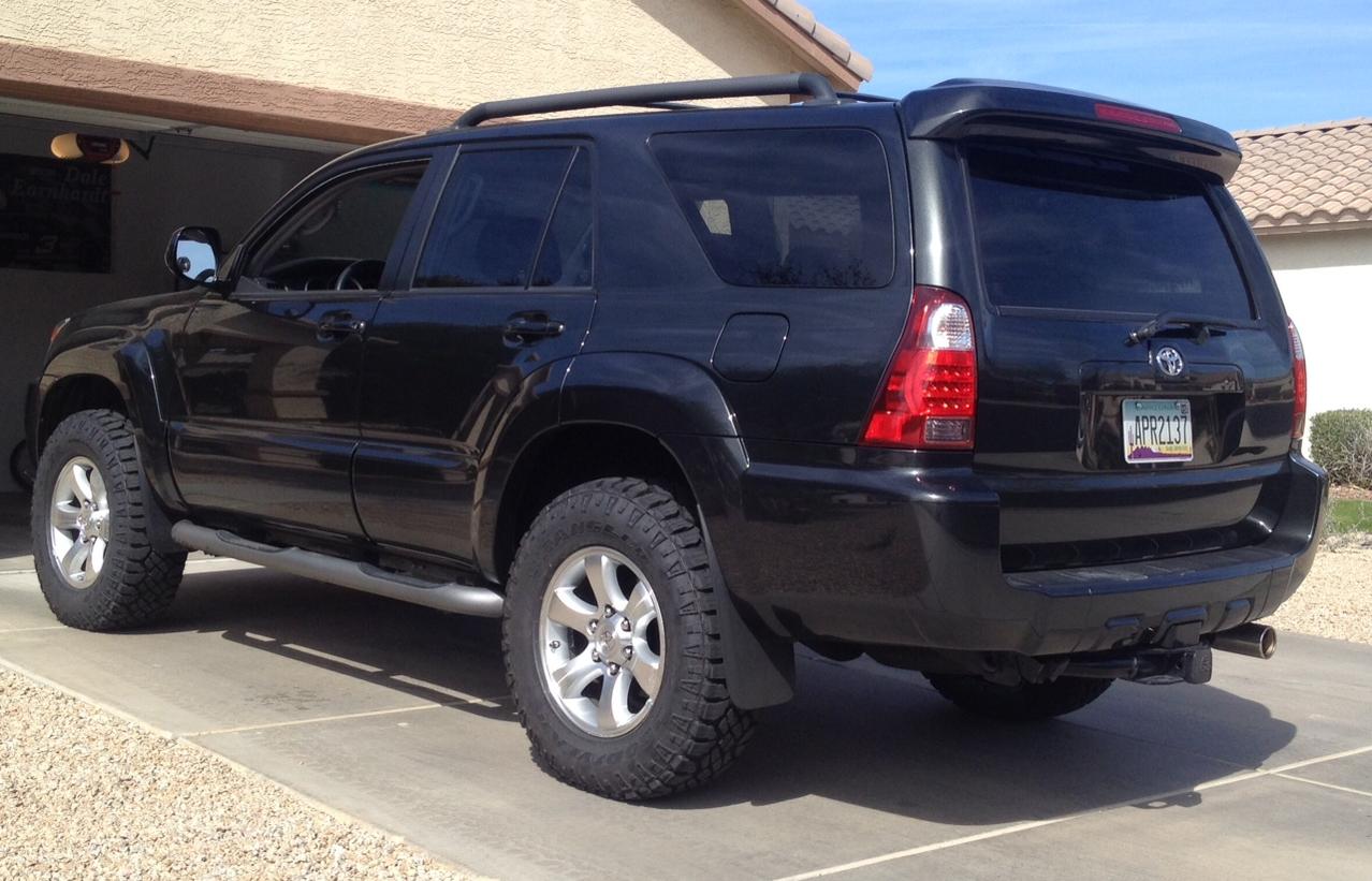

I would like to see the rims you bought? Current I am running wheel spacers and the 0 offset is what I believe I need. I run the Good Year Duratracs but there are a ton of tires out there. I love these but have found they can be tricky to balance and had to find a specific guy at discount tire that I will only allow to touch them anymore. They are smooth when balanced correctly and rotating them alot is a must.
