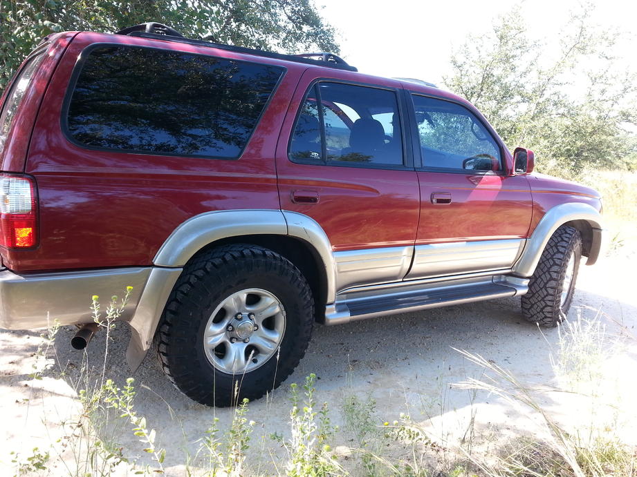

Went with the duratraks, you will loose some mps, actually not even a whole mpg more like about 20 miles per tankful. No snow in central texas but lots of everything else. These are 265/75/16s. Here's how the look before the 1.5" bl coming very soon. :cowboy:
