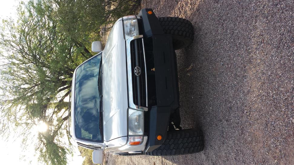

Awesome, I know this is old. I'm teaching myself to post, so here is my project. Thanks for sharing, gives hope that diy can do most anything. Po made the bumpers, because of a wreck. He understated amount of damage, and I desire a high degree of perfect(side lights are out, pass headlight housing is broke, obvious radiator support damage, grill not fully attached, front 2 body mounts are bent). So I'm going to get it closer to perfect. Any advice on radiator support alignment and body mount straightening is welcome. Thanks
