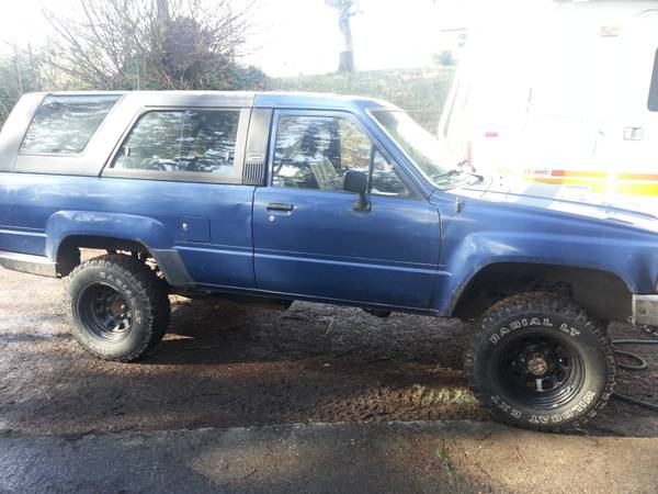

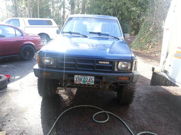

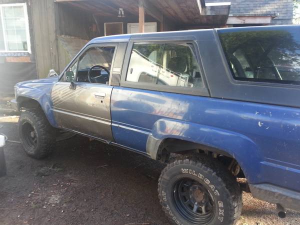

Pics included just to show off my new truck. Picked it up for about $850 worth of trade items.
