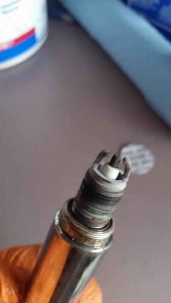

On Friday I usually drive the 'runner to work, so as I was flooring it to get up to speed onto the interstate, she felt sluggish and there was a strange vibration. Then the CEL ( AKA 'money light') started flashing repeatably, it did this a few times. I get off of the interstate, limp the runner back home and take the Subie to work.

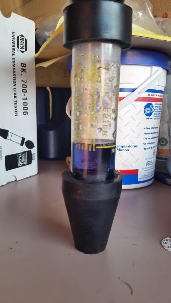

After work I go home I open the hood and check the oil to see if it's contaminated or not. No water mixed in, but the reservoir was empty. No water mixed into the trans fluid, so I take the truck to NAPA to get the code(s) read. P0306 is what I got. After reading so many threads in here and Yotatech, I'm thinking that I've got a blown a head gasket but I needed to be sure before deciding the next step.
I get a leak detector test kit from NAPA. After doing the test twice, I'm feeling pretty good that there's no internal head gasket failure, the fluid never turned neon green.
I pulled #6 plug and found this- I'm not seeing signs of major amounts of coolant being burned up. This has about 10K miles on it.
So now I'm stumped a bit. The coolant is going somewhere, slowly. My next best guess is the IAC valve gasket, I'll order one of those on Monday morning.
What else am I over looking? Any ideas would be greatly appreciated.
Misfire on cylinder 6 plugs can go bad as I just a few weeks ago had a misfire on cylinder 4. How many miles on your plugs?
Mostly if your buring antifreeze you have white smoke coming out the exhaust that just lingers.
Quite possible a small seep somewhere causing you to loose coolant. Not seeing any antifreeze in your transmission and oilis always a good thing.

Plugs have about 10K on them, wires are new when I did the TB service in August. I'm ruling out a faulty coil because I would think that I'd also have a misfire code for cylinder #3 since the coil feeds both cylinders.
I did a cooling system pressure test after I finished the T-belt service, I'll do another one this weekend. I'll also check the fuel rail for static pressure to see if there's a leaky injector. It's possible that the slowly disappearing coolant and the random misfire are 2 separate problems.

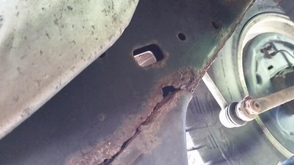

I wanted to focus on getting this rig ready for a Colorado road trip this June, I plan on taking 3 weeks of saved vacation and just enjoying a long trip. I need to at least figure out what's going on so I can make decisions on how to fix / if it's worth fixing anymore because I need to start doing some shake down runs with this truck if I'm going to take it on a 5000 mile road trip in a few months.
It started with removing a rotted out muffler then found this mess. I knew there was some perforation along the lower edge of the frame rail, but as of 2 months ago it hadn't gotten into the lower control arm mount.
Now it's time to decide if I want to deal with this anymore. I love the 'runner and I just got a new 5x10 utility trailer to help with chores in my new( to me) house, so buying a new vehicle is out of the question.
I've seen that safe-T-cap is now selling repair pieces for our frames, maybe that's an option. I'm sure that this is repairable enough to squeeze a few more years of life out of the old rig, I know that I don't have the right welding equipment to deal with that thickness of metal.

I'm more or less at the same place you are with my 3rd gen and I'm in Baltimore. One of my rear shocks snapped in half and I have an OME setup waiting for it. I don't have a garage or great place to deal with switching everything off. I'd like to do it all right, with a diff drop, and panhard geometry correction too.
I also have a little bit of perforation on the inside passenger frame rail of the trailing arm mount and am considering having it patched with the Safe-T-Cap stuff. I had a shop look at mine a while ago, near BWI, that appears to do some custom off-road builds. Their shop looked pretty clean and had some cool fab projects going on. Shop is called Wits End Fabrication. I have not used them for anything more than an oil change yet but they appear to be the type of shop I'd want to do a frame job. Their quote wasn't cheap but seemed pretty reasonable. I know it's a lot of work.

I actually went to that shop in Late May to have them look at the rust. He wanted $1400 just to get started. When he showed me around the shop, I noticed a severe lack of metal fabricating equipment, no metal brake or shear, no plasma table, no acorn welding table, no dedicated fab area. I could see that they were doing metal fab, but if it's all labor intensive using cut off wheels and hand grinding and fitting 'on the fly' I'm just not too comfortable paying for someones inefficiency. The guy seemed like a genuinely good person, like hes not out to screw anyone over .
On a different note- I realized that I never updated the issue with the misfire- turns out the coil that was tripping the code had a hairline crack around the housing, so it was arcing like mad when it got damp/wet. A new coil from the NAPA fixed the issue.

Darn... I don't know the first thing about welding but thought their shop looked clean and saw what looked like a custom bumper being fabbed up. Your pics aren't working for me in this post, nor are they expanding in your album. From the thumbnails, your rust issue looks much more significant than mine. Mine has pretty minimal rot but I'd like to have it addressed sooner than later and figure it will be cheaper now than later.
Since my rear shock broke out, I'd like to address everything at once, including welding in the panhard geometry correction stuff. I'm questioning putting this much money into this rig versus moving on but I'll probably have it done and keep it. I can't wait until I get a garage... I'd be doing the suspension stuff myself and maybe playing with a welder for a few months. Would actually be great timing since I'm still on work-from-home orders.

I've been on the fence about sending the old T4R away, the frame rust has exploded in the past year. 3 years ago I had a shop weld in a Saf-T-cap rear section repair kit. Now the rot has claimed the section by the t-case x-member. I have the capability to weld a repair kit in by myself now, I'm just not sure if it's worth it. I'd only be buying another year or 2 before it needs to get scrapped. I looked into frame swaps, I don't have the driveway space to pull that off by myself. Finding a clean 2WD T4R and using mine to convert to 4WD was another option that I've thought about.
