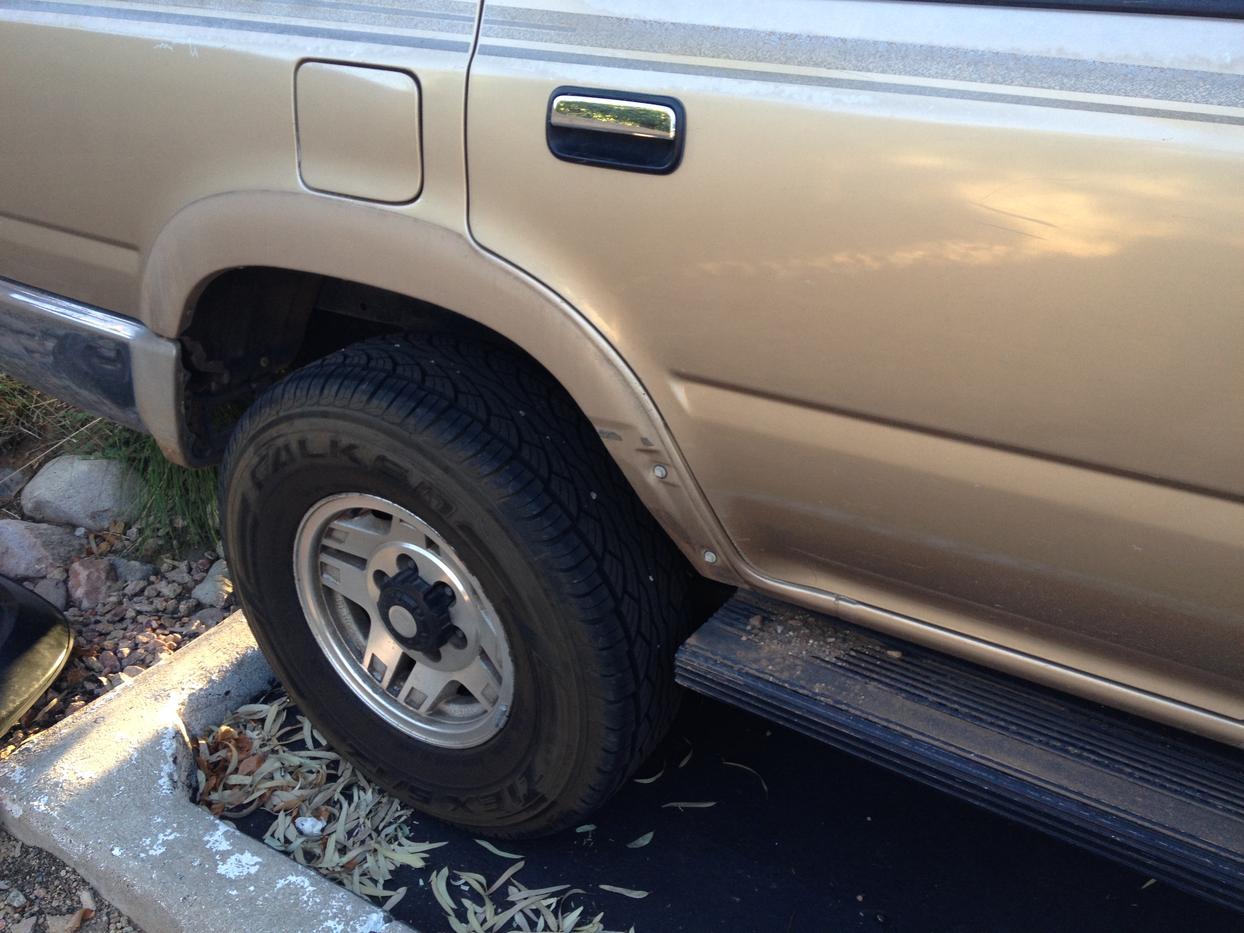

I removed my fender flares from my 95 4runner
and I'm seeing some plastic pieces in the body.
I'm not sure if they make a cover for this or what is supposed to be over them.
I'm currently looking to replace the front fenders with a set of fiberglass and possibly pull the rear fenders as well.
So just let me know if anything looks out of the ordinary here

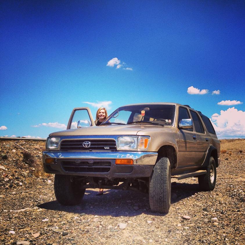

Oh and I'll just leave this here as well ;)

There is a plastic piece for the rear fenders that is stock. It is just cosmetic though. I would not personally worry about it too much.
Small plastic guards, they're on most 3rd gen pickups and 2nd gen runners if you're looking for replacements. Probably 5 bucks at a yard. I removed mine and filled the holes with bondo before painting.
Nice rig. Why replace the fenders?
Thanks everyone for the welcome, I removed them because I have to do some body work on it. The rear quarter panels are damaged

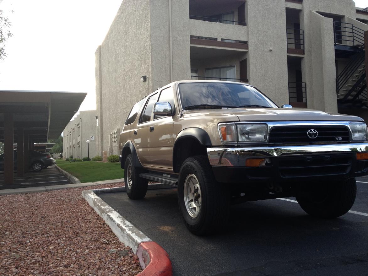

I don't have a close up as I've sold the rig since, but here's one. I just wanted to fill the holes and wasn't too picky since it was a trail rig. I put a piece a tape behind the holes and used the bondo as directed and then sanded/primered before painting. It held up well for my purposes.
To get a completely flat look (you can still see where the indentations were on mine) you would just have to use a little more bondo to get it flush.
IMHO, I'd wait on touching the fenders until I handled the other parts of the truck (like the bumpers you mentioned, lift, tire size, etc.).

Looks great! I am really liking your tires, what size are they?
Thanks. 33x12.5x15. I wouldn't recommend anything over 35s with IFS.
