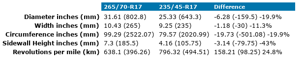

I know this sounds dumb as hell to do this, but I just traded in my STI on a new TRD Pro, and I still have my expensive snow tires that would be superior in the winter and save the stock nitto's some mileage. The stock trd rim is 7" width which will accept my 235/45's. Besides worse gas mileage, looking like a douche and lower ground clearance which is fine for just road driving in winter, will this work without any obvious problems? Just hate to waste amazing snow/ice tires. Thanks.

-19.9% difference is crazy to even consider.
Mounting tires is not just about looks anymore, you have ABS, traction control, trans. speed sensors that are dependent on the tire size. Not only will it look ugly as heck, your vehicle will not function the same.
The load index rating will be way too low. The tire likely wouldn't be able to support the weight of the truck as soon as the truck was lowered onto the ground.
Assuming that the tires did somehow support the weight of the truck you'd run into other problems as previously mentioned: ABS, speedometer, traction control, etc. functionality would all be compromised. Ground clearance would also be terrible, which is probably not something you'd want to sacrifice either.
