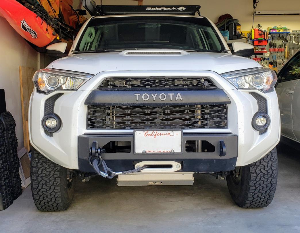

Installed my Warn bumper and Smittybilt 10K winch yesterday. There are a very helpful couple of youtube videos that along with the average instructions that make for an easy install. Bumper cutting was very time consuming for me but it's done right! The TRD Pro skid plate mates up perfectly with the bumper leaving full protection with no gap. I did have a 3/8" front end drop with the 5100 Bilsteins and stock springs. Quality product, fast shipping, good price, what more could you ask for?? I'll post some better outside pics soon. Any light bar advice?

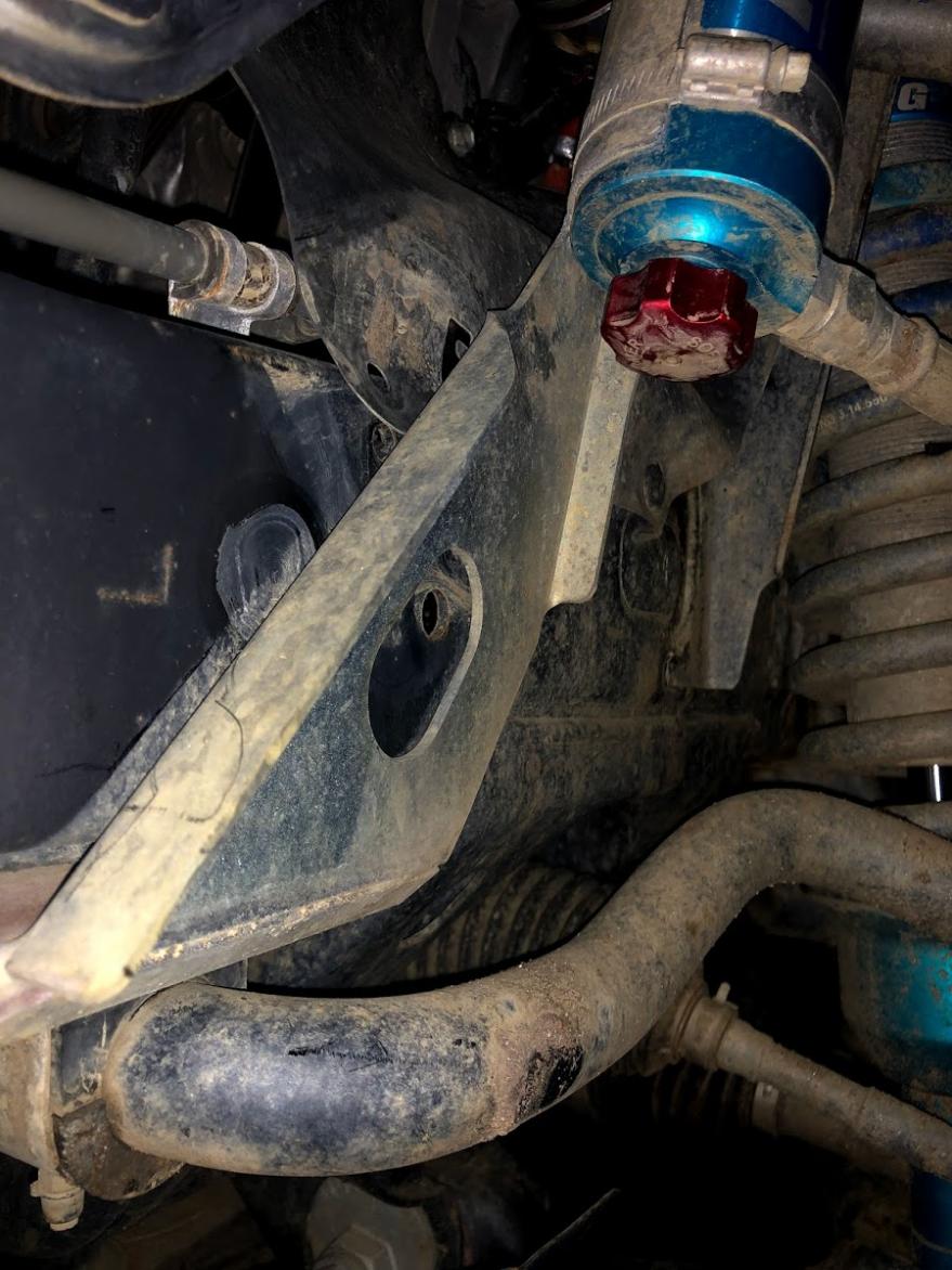

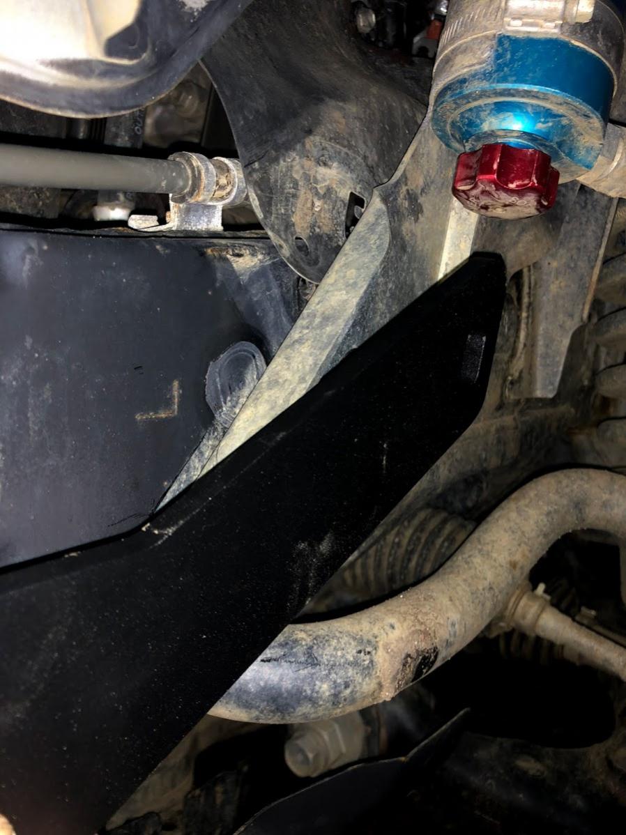

don't get this bumper if u are running king shocks.. the king front reservoir brackets are in the way to install the extra mounting bracket this bumper needs. Not sure if I'll relocate the reservoirs somehow or just get a different loprofile bumper. Or cut the brackets in half and weld them.
Anyone know if other lo profile bumpers mount differently?
(Should have probably cleaned the the 4runner better before attempting the install :D)

Was able to finish the install. Cut those extension brackets to make it fit. That lateral bolt is kinda useless anyway. C4 installs theirs without it as well. Happy how it turned out in the end.
That’s a good idea! I thought the super beefy support bars were overkill while I installed mine as well. Not to mention that installing those supports was the most finicky part of the install. Took forever for them to go in straight and true without binding at one of the large bolts (19mm?) that go into the frame.

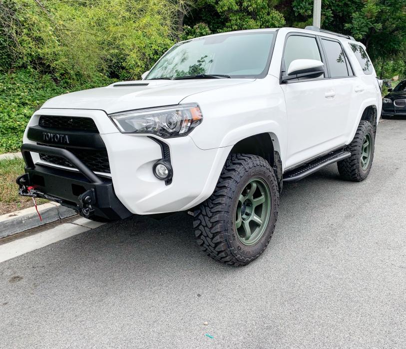

Sans hoop
Here it is without the hoop for those wondering what it would look like. Had a body shop grind it off for $20.
Oh.... oh I like that.... So I'm assuming the hoop is just welded to the surface of the bumper? (not "through" the bumper) After that did they respray the whole bumper or just a touch up?
Correct, welded to but not through. Was going to rattlecan the top face only but the shop beat me to it. If the touch up paint isn't durable then there's going to be chipping during fitment/cutting of the bumper cover unless protected.
