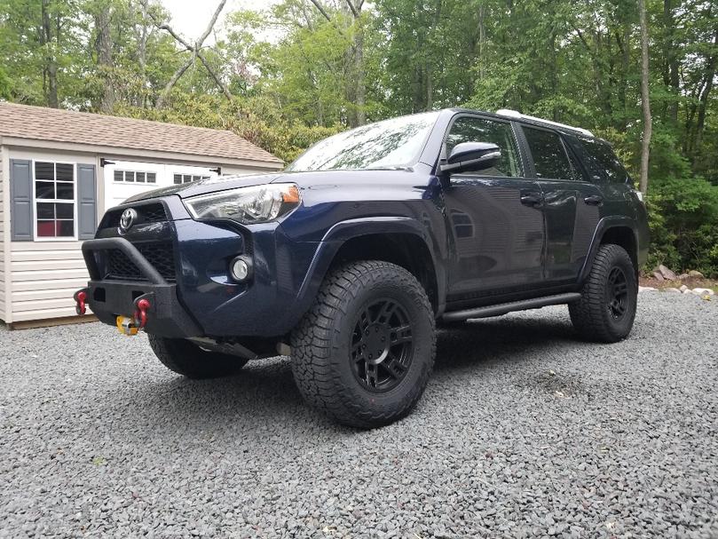

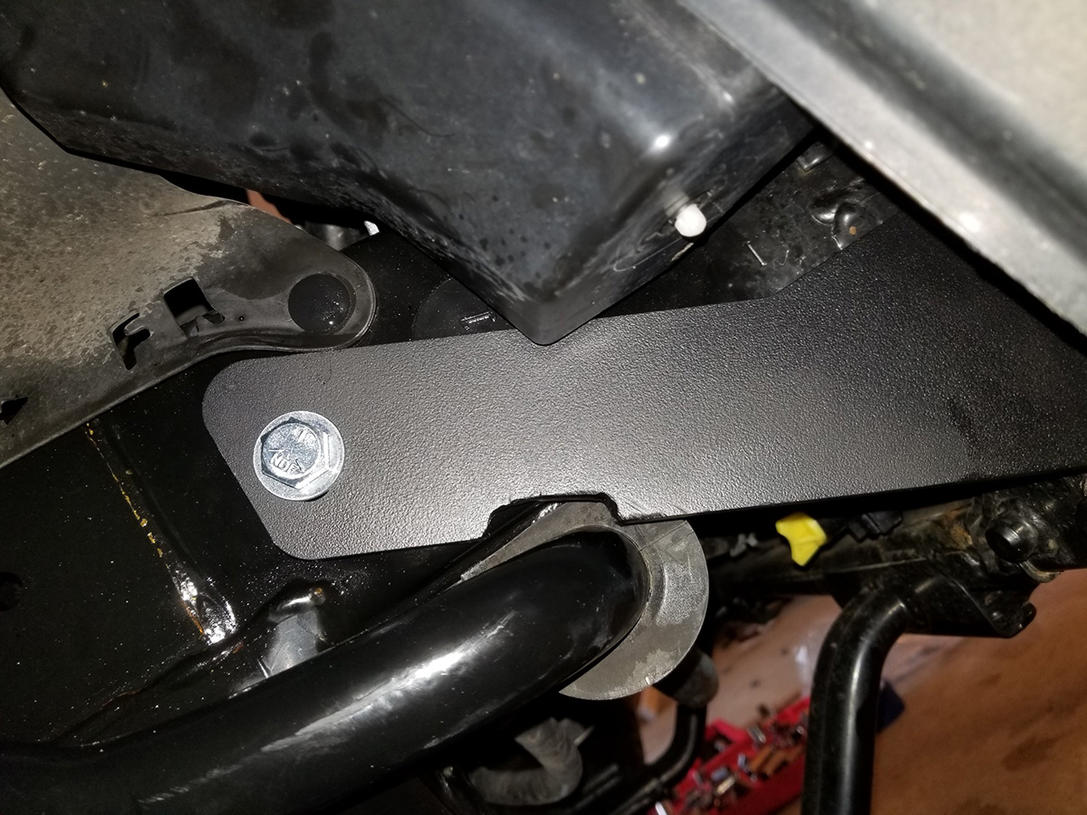

Installed this weekend, only problem I had were the support brackets ended up touching the sway bar on both sides. Ended up grinding them down a bit, pic attached.
Some have mentioned having to drill out the forward facing bracket holes, I nearly did this myself but then ended up using the jack and a piece of wood to apply some pressure from the bottom of the bracket and I was able to get the bolts through no problem. Smitty X20 was a breeze to wire up.
Next up are the RCI skids. On my stock suspension the winch and bumper dropped the front about an inch. I've got my sus gear inbound but figured I'd mention it in case anyone was planning to stay stock height with this bumper setup.
I had the same issue with my sway bars but a sway bar relocate kit solved the issues. It’s probably in your kit that’s coming

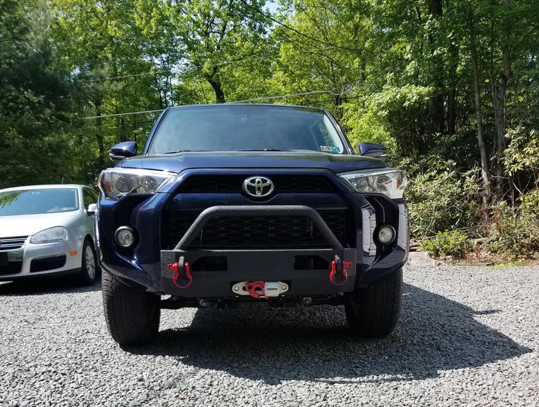

And its on, Used CaliRaised bracket for the single row ExtremeLed D2 30" bar. Warn VR 10-S winch. Since I am an SR5 there was no template for me to use cutting... this was quite a PITA.. other than being a heavy SOB to lift and get a couple bolts started everything else was smooth....
My support brackets are touching my sway bars. What is the danger or issue with that? What is the purpose of the sway bar relocation kit & where can I purchase one?
Hey man, you were right. My fox front sus coilovers did indeed come with a relo spacer. Haven't installed it yet but based on the height of the spacer it looks like grinding those brackets would be entirely unnecessary with them in place.

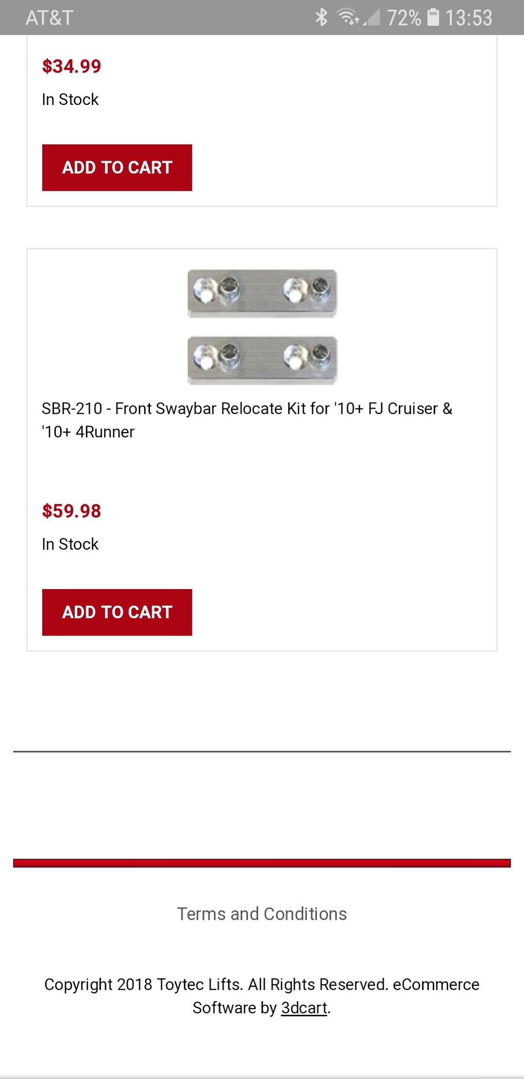

The relo kit consists of a few spacers that drop the 2 sway-bar mounts by about 1/4". Metal on metal is no good and I'd suspect that any bump you hit will result in clanking, if not on regular streets, certainly on trail. I'm not sure where you can grab a kit.
I've got enough room between the support bracket & sway bar to slide a business card in between. Toytec has a sway bar relocate kit for 5th Gens.
