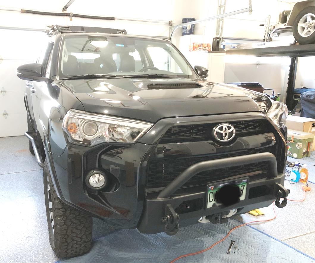

Installed my Warn bumper and Smittybilt 10K winch yesterday. There are a very helpful couple of youtube videos that along with the average instructions that make for an easy install. Bumper cutting was very time consuming for me but it's done right! The TRD Pro skid plate mates up perfectly with the bumper leaving full protection with no gap. I did have a 3/8" front end drop with the 5100 Bilsteins and stock springs. Quality product, fast shipping, good price, what more could you ask for?? I'll post some better outside pics soon. Any light bar advice?
