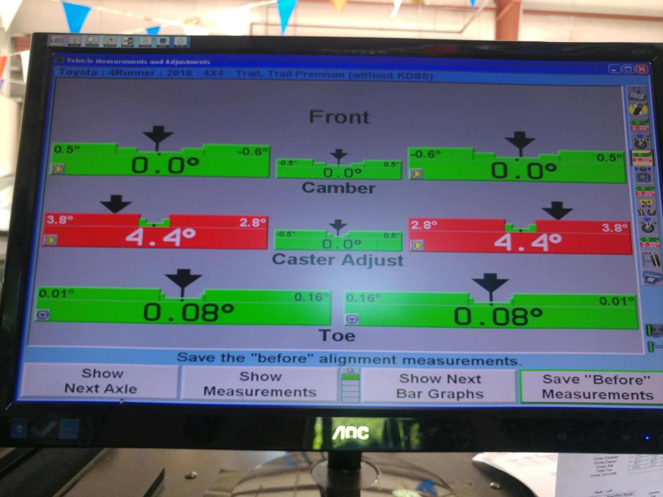

Just had new tires installed and they provided a wheel alignment. I still see red.
Any good? They said they couldnt correct the right front because Toyota dont give the recommended value. What do you think?
Why is the left side green but the right side red?
Suspension = OME BP51
Tires = Firestone M/T2 (285/70/17)
I do not have KDSS.
It seems like the tech that did the alignment is lazy and just did a toe n go alignment. Is your vehicle pulling to the right? Your low caster on the right tells me it will make it pull to the right. Caster on the right should be set slightly higher (~0.3 degrees higher) to compensate for road crown.
Yes, i noticed the steering wheel was was going towards the right, 4runner leaning towards the right. So i guess i need to go back and tell them the Caster on the right should be set slightly higher (~0.3 degrees higher) to compensate for road crown?
My next question is, what if they tell me they "cant" get it slightly higher?
If your suspension is stock they are full of shit.
Doesn't even look like they attempted to adjust it at all.

This is not uncommon problem. Laziness, Time and $$$ are the reasons. Heres a link below that explains more. The adjustment they are making are micro. When the tech gets the adjustments correct and re torques the specs usually go out of range. A good tech knows how to correct for this and when the final torque is done its perfect. This take alot of time and effort. Its tedious work. Here is a pic of my alignment. Your caster will not be as high do to stock UCAs.

So I went back to Firestone they did the re-alignment and FAiLED again.
So I took it down the block to a tire place i usually go to and paid for the re-alignment there and bingo we have a winner. Perfectly straight!!!
I would of bought the tires there but they were more expensive. So is their wheel alignment which cost me $136.00 for (1) alignment, but they got it right the first time. So i'm not complaining.
All GREEN.

I'm glad it worked out for you. I've had Firestone alignments on other cars in the past and generally they were not very good. For my lifted Tacoma I've had the best alignments from independent shops when they let me pick my alignments settings. Firestone only use factory settings even on lifted trucks.
Toyota dealers are just as bad as Firestone on alignments. They tend do "toe n go" alignments if camber and caster are green even if they are not ideal. When my T4R was new it pulled to the right on the freeway so I had the dealer take care of it. The 1st time they aligned it, they only adjusted the toe and the caster was still 0.5 degrees lower on the right side although still within the spec (green). Before I even drove away, I knew it was still going to pull right on the freeway and I was right. I went back the 2nd time and let the service advisor know about it still pulling to the right and that the low caster on the right is causing it. The dealer had a more senior tech redo the alignment and he added more caster on the right side. After that it tracked straight on the freeway.
Since yours if lifted you should shoot for 4.5 degrees of positive caster when you get an alignment next time. 4.5 degrees will be out of spec per Toyota factory specs but it will track nicely on the freeway.
