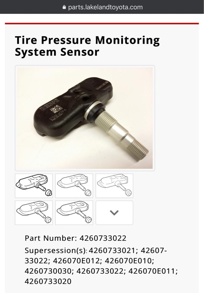

You can either re-use your oem tpms or get another set. If you re-use the oem ones, no programming needed. If you add new ones, you’ll need to add program them into your trucks.
If your adding a 5th tpms, you’ll have to program that as well.
Yes, I have a set of TPMS sensors in my summer wheels as well, and the tire shop reprograms them when I swap wheels.
thanks, so if you rotate/swap wheels you have to reprogram your tpms every time?
is this something you can do at home with a tool? i got my tires through costco and they will only install the wheels on the tires (won't install on vehicle because i upsized).
Only if replacing set of wheels with summer or winter ! No worries on rotation , I stored my xtra wheels in garage & never had light come until left town & were away for 72 hrs :cheers:
I have the SR5 and use 5 tpms. i've included my spare in the rotation and replaced my steel rim with the alloy rim and a new tpms for my spare.
I believe only the Limited models ECU can store 5 TPMS sensors. Any other model, can only store 4 sensors in the ECU.
