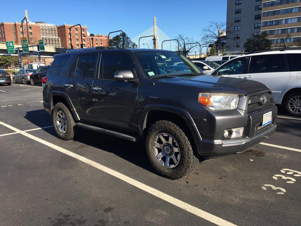

In April of 2016, with 43,000 miles on the clock, I got a new set 265/17-17 BFG KO2 Load C installed on my factory 2010 SR5 17"x7" wheels. I had the car aligned. I played around with the pressure and found 38-ish PSI to be the best for me.
I have rotated the tires twice. There was always even wear. I should point out that I have always had Spiertrax spacers on, never an issue.

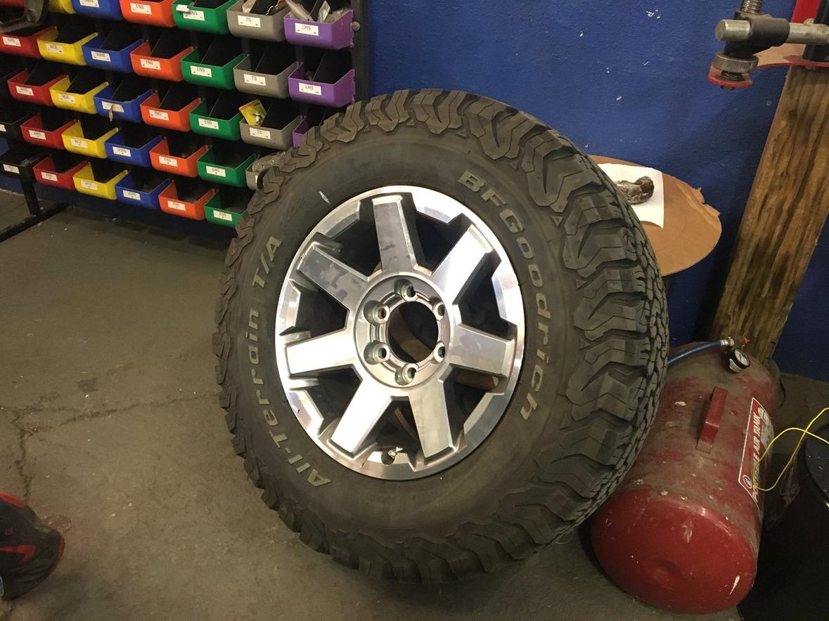

In November 2017, at 53,000 miles, I got an almost new set of OEM Trail wheels, 17"x7.5" from a forum member. I switched my KO2s and pressure sensors to the new wheels. I flipped the tires around so that the white lettering is out, just for giggles. Mounted, balanced, aligned, everything was beautiful.
Then, almost suddenly, I noticed a lot of tire noise on the highway. Typical, old, humming, annoying, tire noise. It's getting progressively louder and more audible at lower and lower speeds. Current mileage is 55,500.
The tires are mounted properly. They're not directional. Pressures are good. Proper alignment. Proper torque on lug-nuts. The thing drives and brakes straight. Everything is perfect except for the damn tire noise at over 35MPH.
I am truly puzzled by this. Could it be because I flipped the tires to white sides out? But that would be the same as rotating them.
Could it be the half-inch wider wheels? Or the half-inch wider wheels + spacer combo? It's a popular set-up and I have not heard any complaints.
Could the KO2s have just reached that magical mileage where they suddenly get loud? I've seen people complain about that.
I'm bringing the 4R to another shop tomorrow. I'll explain everything but I don't think they'll find anything. I guess I could start experimenting but... ugh... I don't have a garage or the time to play around with this.
Suggestions?

I also want to mention that other than the road noise, the tires have been nothing but awesome. In fact I'd say these are the best tires I ever had. Most of the time I don't even switch 4WD in New England winters.
By changing wheel and tire rotation (inside is now outside) you changed how the tread will hit the road. I'd bet that there was some very slight amount of cupping or wear on the tread blocks that is now making noise. I'd let them wear for a few thousand miles and it'll probably go away.
Just my guess. Otherwise it's plausible that it's wind noise from the tires catching the air differently, but that seems pretty unlikely. It's a small change. So it shouldn't make much difference.

So, if now I rotated them side-to-side, as opposed to front-to-back, I should have them rotating in the same direction.

You normally do want to reverse direction during the rotate with two tires - so over time they all end up in every position on the vehicle. The only thing you don't ever get to do in normal rotation is to change the tire wear from inside to outside. For example if the outside of your front tires is wearing quickly as a result of excess toe - you can't fix that wear pattern even if you swap side to side - it's still the outside, just on the other side of the vehicle. So if they were feathering or wearing just a little different, putting the outside on the inside might make a little difference.
The reality is that front tires almost always wear a slight bit more on the outside as a result of toe in. And by putting them on the back they wear the rest of the tire down just a bit and re-level it all out. By keeping them rotated it constantly fixes the uneven front wear, but also fixes the fact that the rear drive tires wear out faster. Running them every different way helps keep all the different wear patterns balancing eachother out.
I would just drive it a bit and see what happens. I don't think you did anything wrong. It's just an odd anomaly of wear that might cause some noise for a few miles. If you keep on a regular rotation schedule it should self correct. It was probably just as likely that you would have made them quieter. You probably wouldn't have noticed it in that case.

Not sure about the tire noise, but good god man, get some Ajax and a scrub brush on those white letters! :D
:biggrin2:
Haha, this was when I just flipped the tires after 10k miles of crap. I ran thru a car wash twice since then... looks the same. :(
