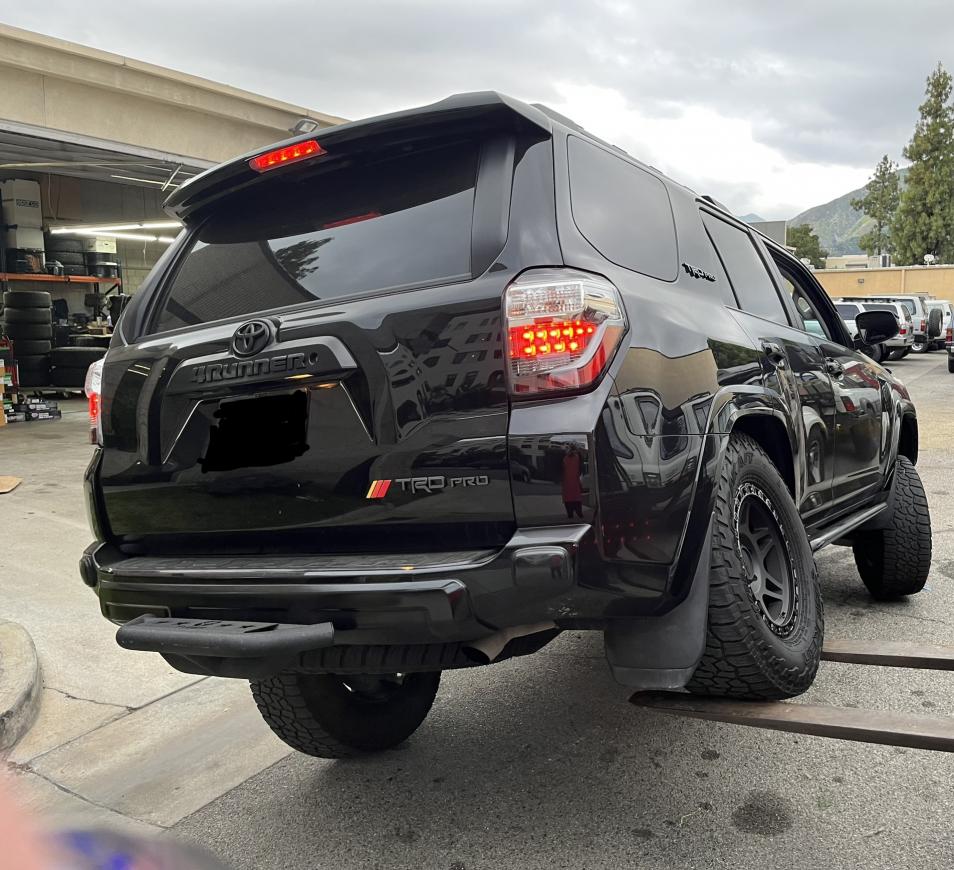

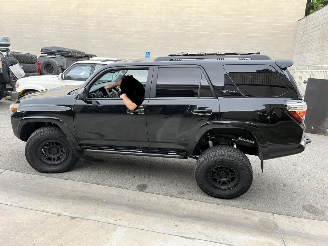

OP, it depends on your lift height for UCA’s. In most cases, if you are above a 2” lift it is advisable to get UCA’s to maintain the proper geometry through the front suspension range. With the proper alignment, UCA and wheel offset you should only have to do some light front fender trimming and pushing the liners forward a bit. If you can get close to 4 degrees of caster out of the UCA, there should be no need for a BMC with 285/70-17’s and the right wheel offset.
I have a Radflo 3” lift, Nolathane UCA’s at 3.7 degrees caster, Method 17 x 8.5 x 0mm offset wheels and the front fender trim that the Pros come with from the port. I just pushed my liners forward and I have no BMC and I am still running the OEM mudflats that I like. It came out as planned with clearance in a close to maxed out articulation. GLWYD.
