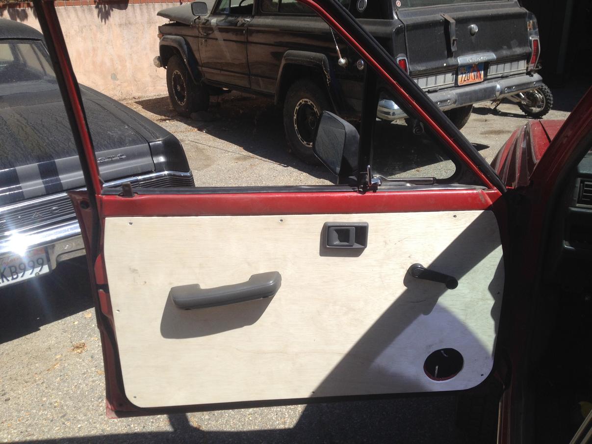

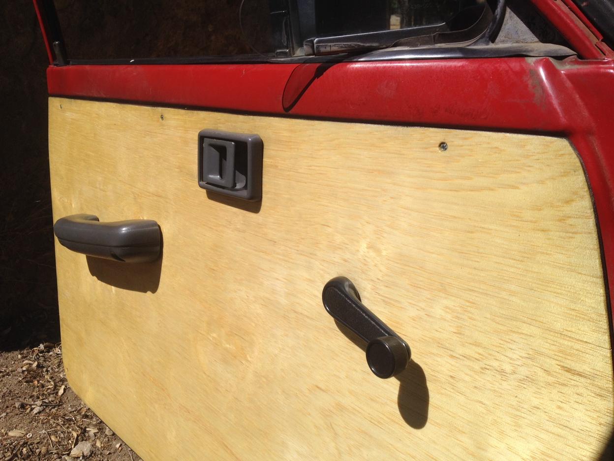

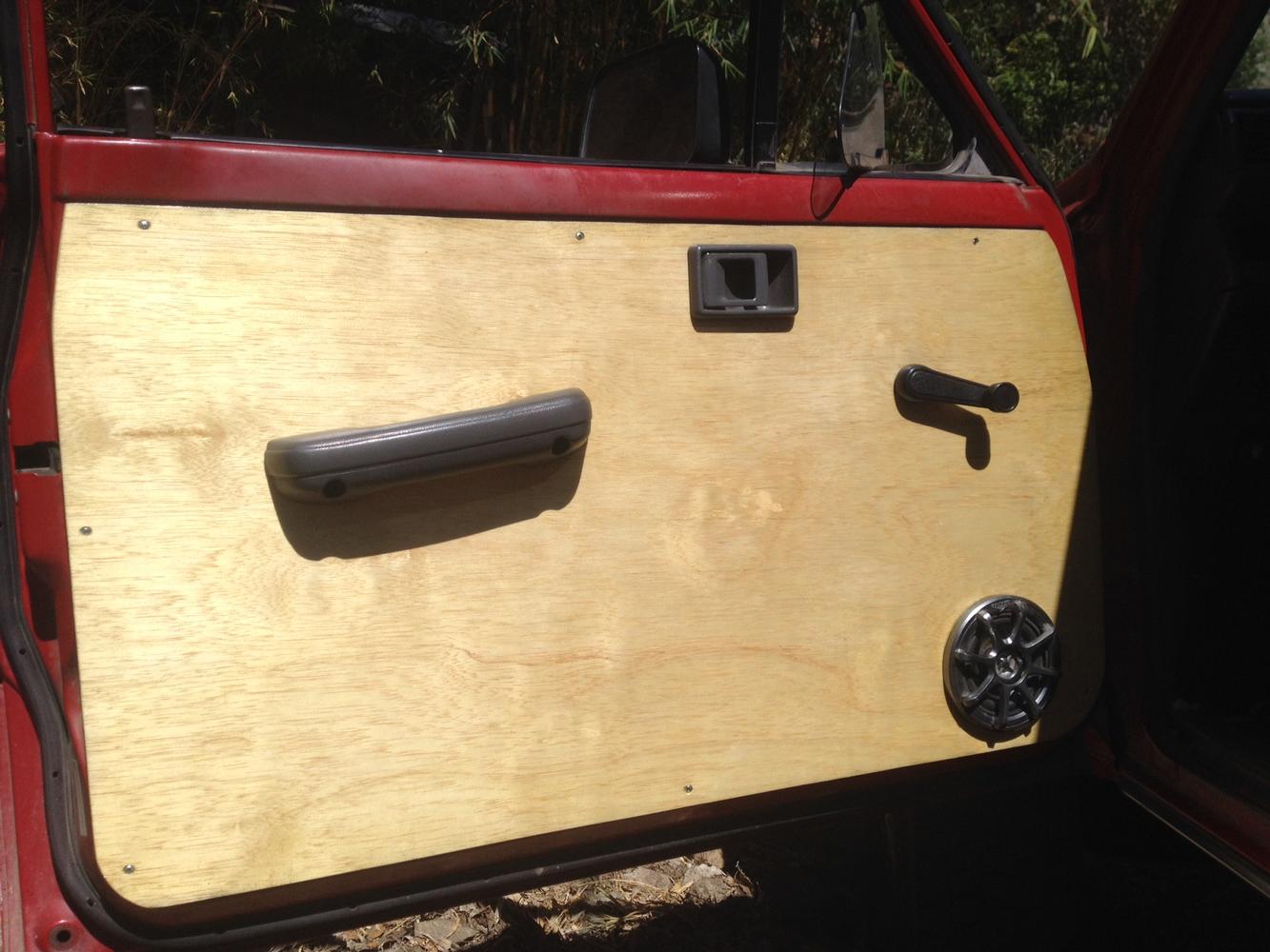

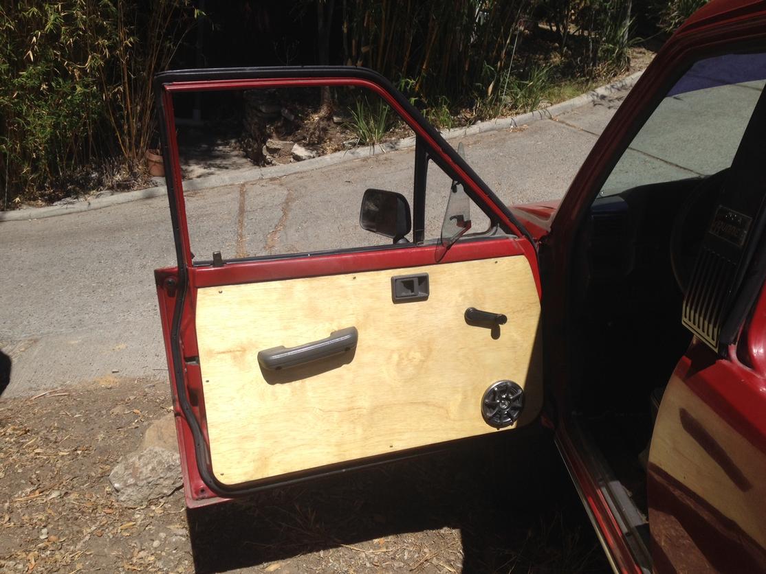

Did these after I saw [MENTION=82455]dorton[/MENTION] 's panels that he made. I liked the look of the exposed top rail. I used marine varnish after contemplating rhino lining them, glad I didn't.

Thanks guys. They were pretty easy to do. Im gonna go back and put some adhesive cushion between them and where they contact the metal on the door, they are getting a little squeaky and beginning to rattle a bit. Otherwise Im very happy with the turnout. I bought some more speakers and plan to do the back seat panels next. Maybe I will figure something out to replace the ones in the bed. like a thicker plywood lined with diamond plate.

Looks clean! and no stupid, tricky hidden fasteners. Consider finishing washers for a cleaner look?
... Im gonna go back and put some adhesive cushion between them and where they contact the metal on the door, they are getting a little squeaky and beginning to rattle a bit.
IF they end up rattling from the speakers, might want to try thicker plywood (there's plenty of room there anyway), or line the side facing the door with sound-dampener; in expensive substitute for Dynamat is peel and seal or Frost King foil and foam insulation. P&S works well for me.
