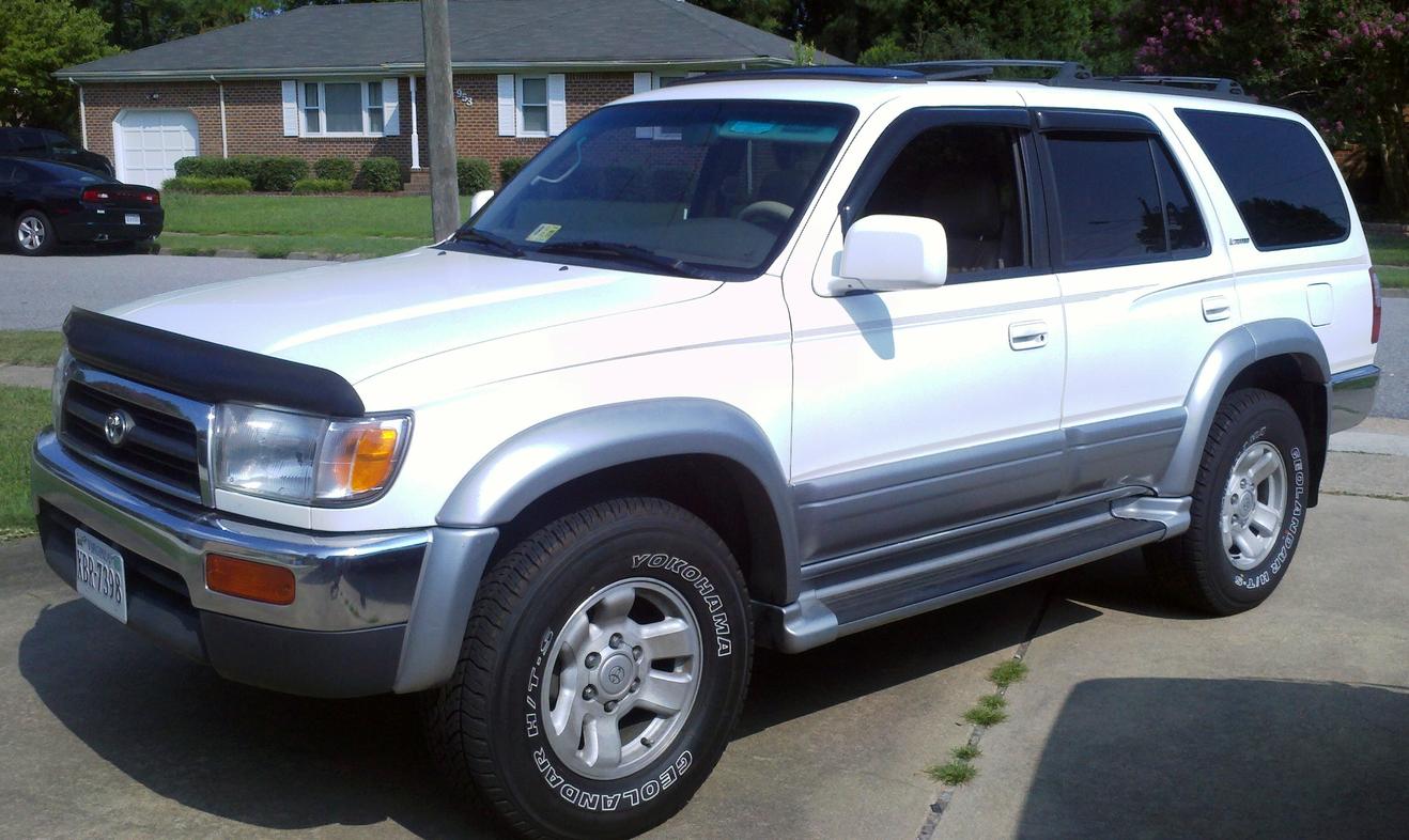

hey guys! new to this forum and wanted to say hi to everyone! I bought my 98 yota a few months ago and im loving her! :bravo:
i am looking to do a 3" lift. dont know anything about any of that stuff...so any advice would be awesome. got a quote yesterday for the bilstein lift kit $1500 installed. i really dont wanna have to worry about changing the tires right now or at all if possible (they arent cheap lol) and dont know anything about tires either :-(
i just want the clean but aggressive look!

Welcome, that's a nice 4runner. It looks like you have nice tires, the Geolanders are a great tire. For a lift, there are quite a few options. Personally, I would like to see someone do this lift, because I think it would work awesome for a moderate lift with a great ride.
-Front OME 881 Coils ($169)
Front OME Coils (95.5-04 Tacoma & 96-02 4Run) - Toytec Lifts: Toyota Lift Kits: FJ Cruiser Lift Kits, Tacoma Lift Kits, Tundra Lift Kits, 4 Runner Lift Kits, Sequoia Lift Kits, Toyota Truck Lift Kits
-Front Bilstein 5100 series adjustable struts ($199)
Front Bilstein Height adjustable front 5100 shocks - Toytec Lifts: Toyota Lift Kits: FJ Cruiser Lift Kits, Tacoma Lift Kits, Tundra Lift Kits, 4 Runner Lift Kits, Sequoia Lift Kits, Toyota Truck Lift Kits
-Rear OME 906 coils ($169)
Rear OME 906 Coils (96-02 4Run) - Toytec Lifts: Toyota Lift Kits: FJ Cruiser Lift Kits, Tacoma Lift Kits, Tundra Lift Kits, 4 Runner Lift Kits, Sequoia Lift Kits, Toyota Truck Lift Kits
-Rear Bilstein 5100 series shocks ($199)
Rear Bilstein Shocks for 96-02 4RUN - Toytec Lifts: Toyota Lift Kits: FJ Cruiser Lift Kits, Tacoma Lift Kits, Tundra Lift Kits, 4 Runner Lift Kits, Sequoia Lift Kits, Toyota Truck Lift Kits
Total - $736 plus shipping. Install is free if you find some local t4r.org guys to help you out! :)

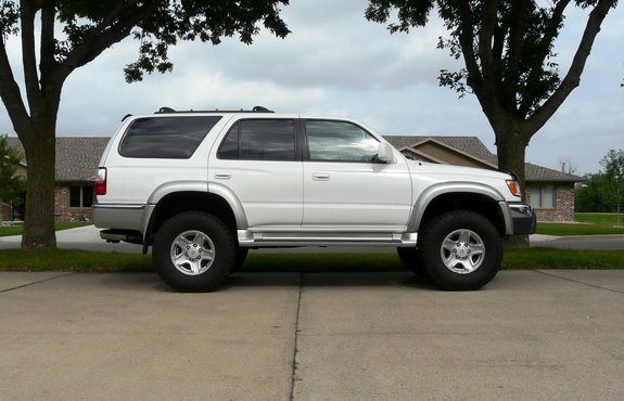

your sig says you have a highlander but your pic is a 4runner! how much lift is on that? and i like those tires too.

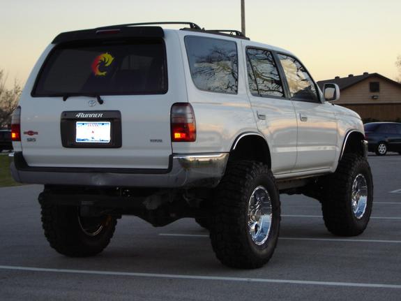

this is what im going for!
second pic has running boards!! ;-p
highlander is a trim level that was offered on the 4runner before it became it's own series of vehicles..............
