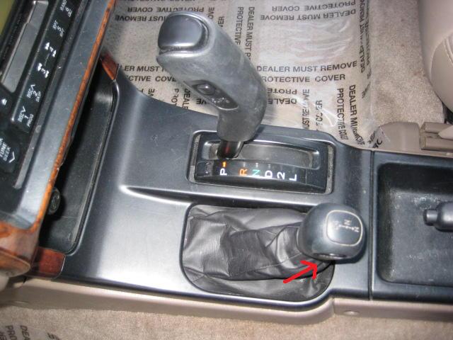

Alright does this photo mean that this runner is an AWD with only 4H and 4L. Sorry to keep harping on this issue just trying to learn all I can from the guys that drive them all the time. Photo is of a 98 limited

Alright may have answered my own question. Does the button on the side of the gear shift engage the 4x4 in 4H and also disengage back to 2H.

Cruiser, when you have that lever in "H" without the 4WD button pushed in, you have it in 2WD. "N" disengages the transfer case, giving no power to any of the wheels. "L" denotes L4 range, where you must FIRST put the drive lever in "N" and then shift the 4WD lever to "L", then put the drive lever back into "D".
To engage 4WD while in motion (at speeds up to 60 MPH) just keep the 4WD lever in "H" and depress the "4WD" button on the side of the 4WD lever.
At least in my 2002, the 4WD system could technically be described as an AWD model, because you can drive in 4WD mode in all conditions (wet dry etc) thanks to the center differential. Locking the center differential then turns it more into a 4WD truck than just depressing the "4WD" button
I have the same shifter on my 2002:
