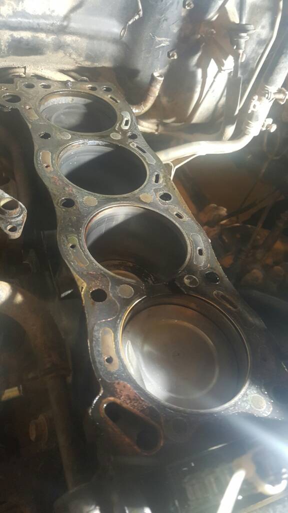

I just pulled the head last night, my bad, didn't do leak down test.

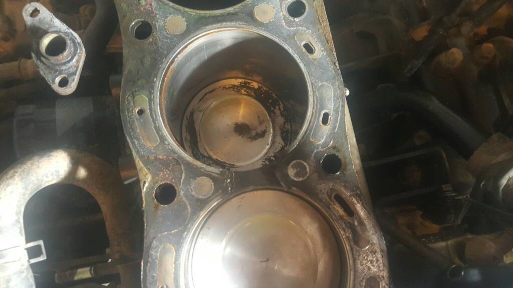

headgasket between 1 and 2 is completely gone :*( don't know where that piece went!
Timing sets are cheap. So's the water and oil pump. Engnbldr can hook you up with good front end stuff that'll last 200,000 instead of 20,000.
Is it stuck to the bottom of the head?

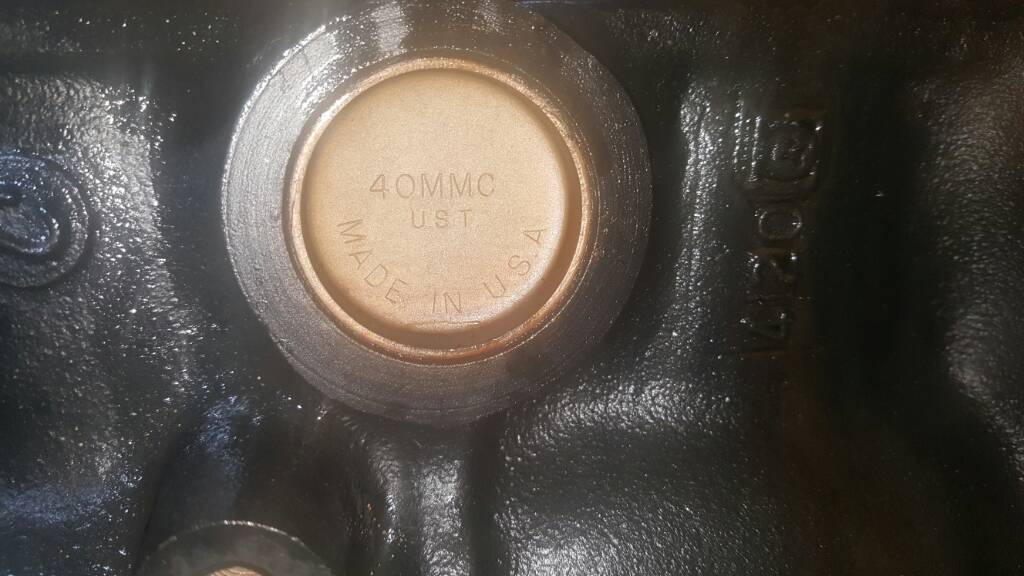

What chinese parts did he put in the head?
If he made poor choices in the top end, why not the bottom? Cylinders don't look great on my small laptop screen, hopefully better in real time.
