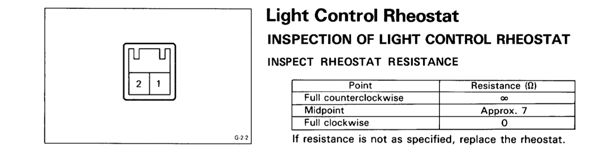

See below for a test of the dimmer rheostat. I would be hard press to think that all you bulbs went out. Here a link to the FSM and 88 Wiring Manual. Troubleshooting for this starts on BE-1.

As for the dash, I should test the dimmer rheostat before pulling the gauge.
