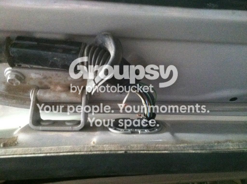

Open the rear and take off the paneling.
There is an entire "box" in there that all the controls for that window lead to. Check that they are all plugged in and what not.
Common failure point for wires which can result in any type of rear hatch problem. Probably a few broken in your case.
The rear wiper and dome light would not have been affected by a window lock switch.
After you check the box have a look at all the wires. Check the wires between the hatch and body there could be a break in there somewhere. Because the window goes up and down with the key your relays sound like they are working. You could also check the inside switch with an ohm meter. The copper inside of the switch might not be making contact.

I'd take another look at the wiring from the body to the door. It's sure sounding like a wiring issue.

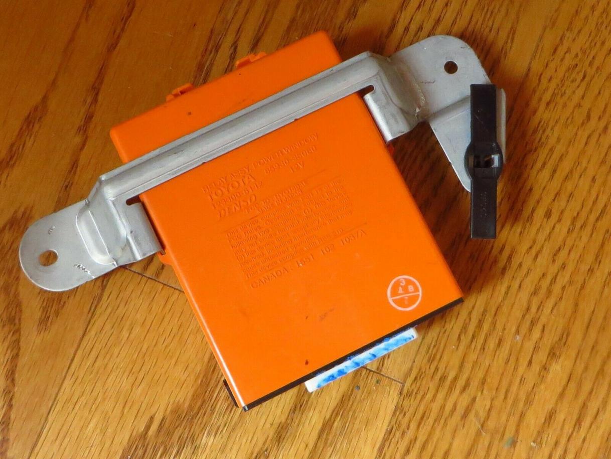

Mine was doing the same thing, the large orange relay unit inside the tailgate was the culprit:
REAR WINDOW RELAY MODULE 85930-35040
