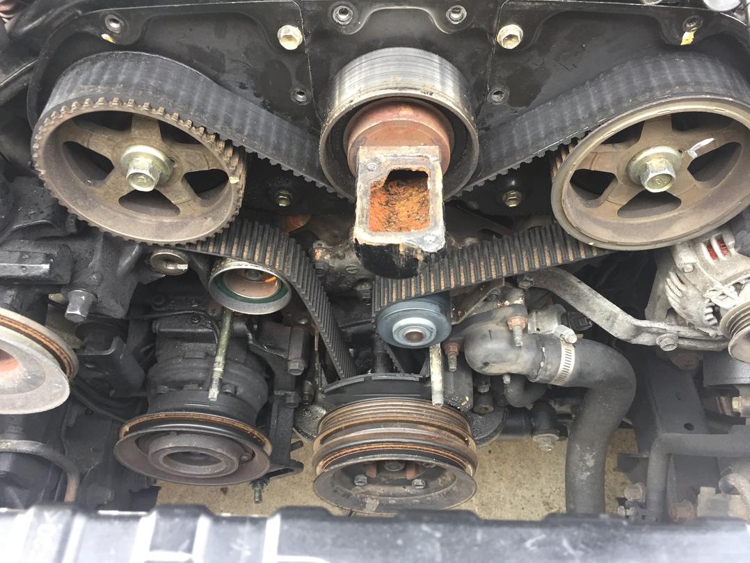

Efi fuse and relay are both... Tested relay with voltmeter. As of right now I'm almost all the way tore down to check timing. Very good points were I have fuel and spark it's gotta be air, I'm pretty sure hats good... I covered the tb with my hand and started cranking it.... It sucked on my hand pretty good. Lol. So it's gotta be timing. I just didn't wanna accept it being that... Lol. Not the work, just time consuming. But might as well replace water pump idler pulley and belt since I'm in there
