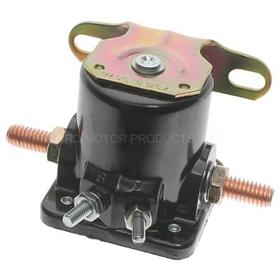

No, but most do. Anything with a floor button, like old jeeps, tractors and school buses, has no solenoid at all. Many cars and trucks used to have the solenoid separate from the starter, but that is rare these days--not so rare when our trucks were built.
Here is a stand-alone solenoid used in many Fords:
It is worth noting the Denso starter solenoids also have a mechanical function to engage the pinion to the ring gear, eliminating the classic "Bendix."
My old Johnson outboard has a starter solenoid that looks identical to that...
That type of solenoid what I was referring to. It started fine after I replaced the contacts...that a year ago..this just started all of a sudden.
