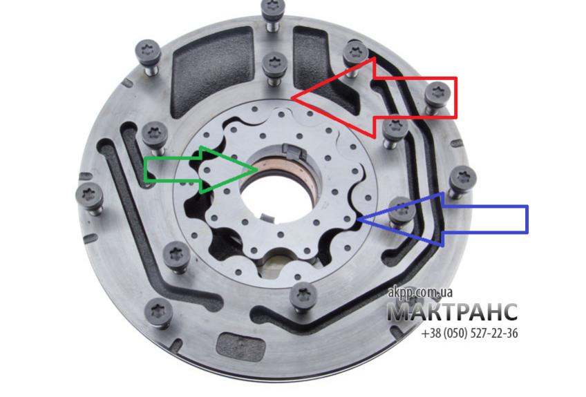

If it's not too much detail, I'd love to understand better for my own curiosity where the scarring and seizing happened. I can see two obvious places where there would be close tolerance bushing that could have issues if they ran dry. In my super amazing MS Paint arrows below, there's one bushing surface where the red arrow is that would be where I'd first expect a problem. The second place is a bronze lined bushing with oil pockets that seems like it must be prone to oil starvation based on the design. And the third is the actual pump cavity. That is where I wouldn't expect a problem unless a foreign body was introduced via the oil flow and then got compressed in there and caused damage.
Here's a closer picture of that bronze bushing I'm thinking of that the green arrow is supposed to be pointed to.
One other thought just to keep in the back of your mind - it's possible that the failure was unrelated to the oil swap and something just went bad randomly that out of pure luck happened at about the same time. It's not likely, but not impossible. The reason I say that is it seems like under low rpms and light load the pump should have enough residual film to run dry at least for a short period of time without damage. That I've had an auto transmission in the past that broke a cooler line and pumped out all of the oil completely until it stopped moving. I refilled it and it worked fine. It was a GM TH350 a long time ago. Very different transmission, but it uses the same basic design for the oil plump. So it might have just been shitty luck.

After taking down front of transmission that shop showed me that my pump gear was sticking likely due to me running the transmission between filling increments of ATF to pump out of return lines. I did this at 2quart increments. He said it is likely that the pump drained the pan too quickly for me to fill during one of those increments and was enough to cause scarring in the pump gears which overtime got deeper and eventually sheared the pump gear off of the torque converter. So luckily no rebuild but will have to replace torque converter and pump along with various seals and o-rings totaling around 3,300 with parts & labor since they serviced my T-case before dropping the whole transmission to rule it out. My clutches looked great and everything else behind the pump so likely no damage to other parts further back in the transmission.
