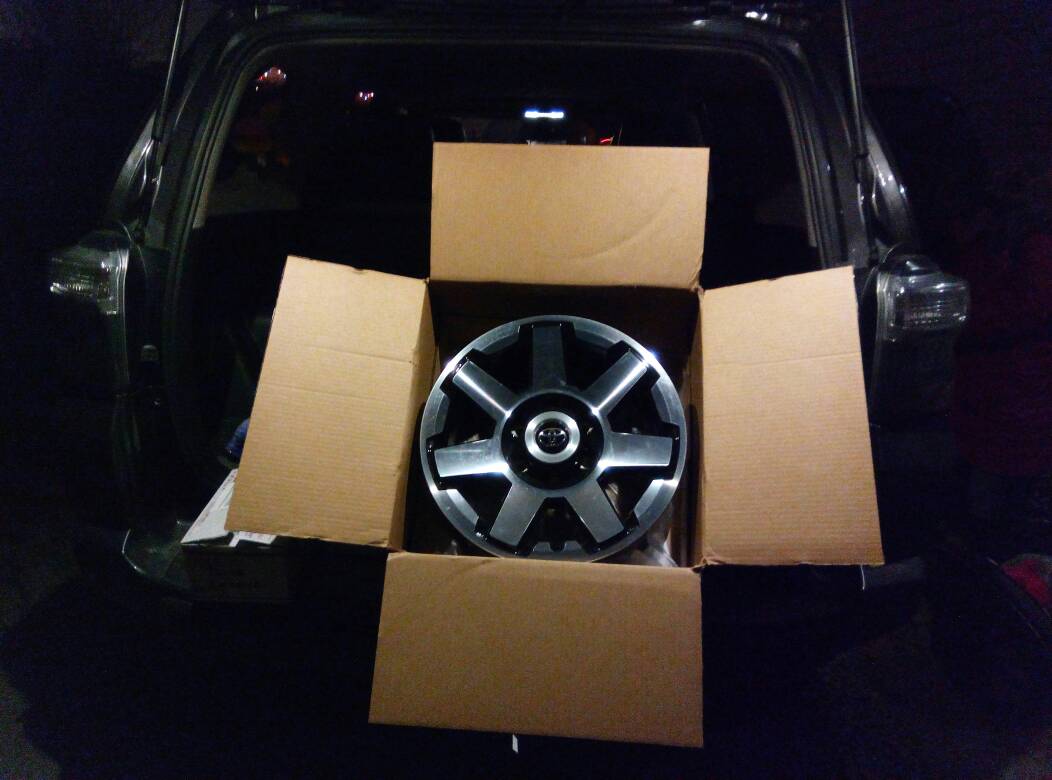

I read somewhere that we have tpms sensor on our spare wheel.
So I bought another trail edition wheel to mount my spare tire on it so I can do proper tire rotation.
Tire shop left me a message to let me know that I don't have any tpms on my spare tire...
Is that normal? Can I bought a tpms sensor from the shop and have it program so the truck read all the 5 tire?
Thanks
